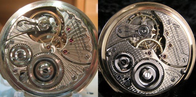

I dug through my "bunns" and found a 2 year later vintage 2875236 . . . .
October 07, 2008, 19:14
That has the "conventional" wheel and spring. I am sure that yours was a (very good idea) "jeweler's upgrade". They are beautiful to behold in either condition! One other interesting thing about your elinvar conversion, the mean time weights appear to be screwed all the way in, or are not there.

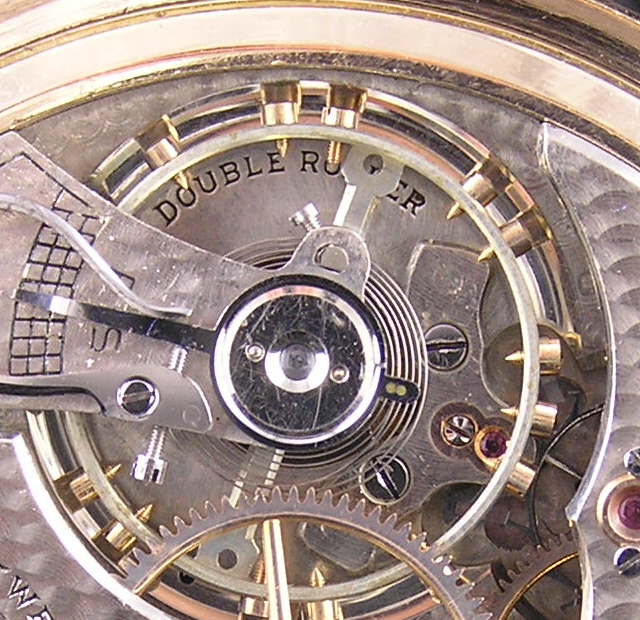

Chris,
You posted while I was writing but lets try this.

Steve, I think that to "reverse" the long ago upgrade of that beautiful watch which also would "reverse" the "Karma" of that watch. That is a great watch to enjoy, carry, and someday use to share the story of how these could have been upgraded when the opportunity presented itself.
Another thing yours and my watch both show is the peculiar "upside down" balance jewel screws that Illinois did for a few years. That yours remains as original says volumes about the professional quality of the conversion for more accuracy.

Dave,
I agree that it was something that had to have been done a long time ago and it is not hurting anything the way it is. Also, as optimistic as I want to perceive this, it may have been done by the original owner who dearly loved this watch (very easy to do) but yet wanted a top of the line timekeeper. Who today would part out a 161 or 163 Elinvar and put it into a 21 Jewel Bunn Special? With that being said, how many fish scale Elinvars are out there?

Great photo, I agree with Dave would leave it exactly as is, more of these will no doubt show up in the future.

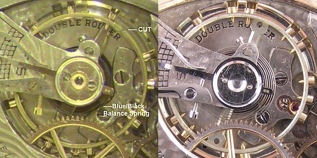

Sheila, I attach a picture of a "normal" Bunn balance wheel (that Steve just won on eBay) next to Steve's "improved" Elinvar Bunn type with a couple notes to help you understand the difference;
1. Non-Elinvar uses CUT wheel and uses Blue/Black balance spring; The wheel is "CUT" in two places around the periphery of the rim to allow the bi-metallic wheel rim to contract and expand with temperature causing the balance wheel to oscillate (spin slightly faster or slower to offset the OPPOSITE temperature effects causing higher and lower spin resistance of the balance spring which is Black or Blue steel in color.
2. The usually whitish color Elinvar Balance spring has imperceptible changes in spin resistance through the normal range of temperature, so there is no need to use a Bimetallic wheel with cuts for temperature compensation. Thus the Balance wheel is solid. Some were made with Invar, or similar super-stable alloys.
