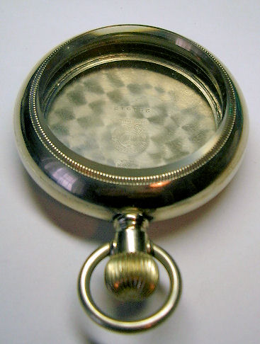

March 13, 2006, 10:03
John WoolseyTop View

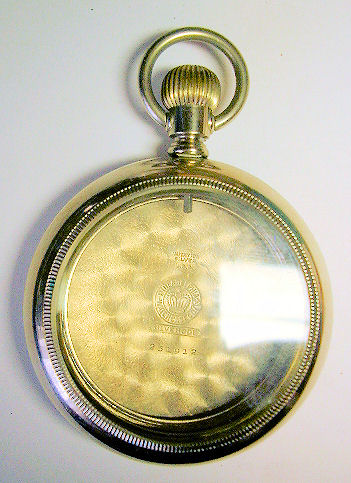

March 13, 2006, 10:04
John WoolseyCase Back

C. Keith JohnsonJohn, You probably will get replies from those more expert than I but it appears to me that you have the easiest case to fit a movement in that is made. I think it is a standard 18 size case and will take any standard 18sz American and some foreign movements except one that requires a female stem. It will take pendant set or lever set movements, open face or hunting as a sidewinder. In my experience the 18 size movements were mostly made to the same dimensions unlike the variations that can be found in almost all smaller sizes. Among your movements, do you have an American 18size movement that won't fit this case? Good luck................Keith
March 13, 2006, 10:34
Terry HillIt appears to be a standard 18s to me also, the lever position is another 'tell'... most 18s movements have the lever at the 2 o'clock position...

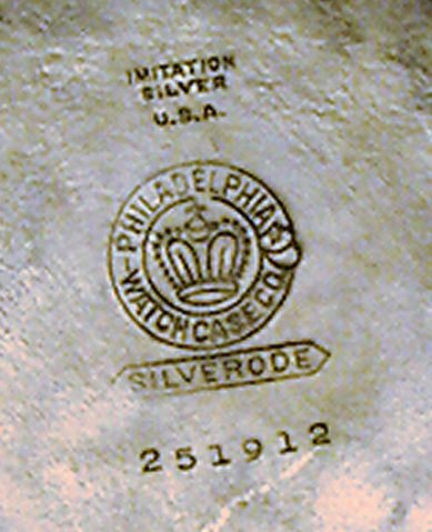

Lindell, I've attached a close-up of the crest now, so hopefully someone will recognise it.
I wondered if it was nickel, just never seen it described that way before. Wonder if it was as you say, something to do with imports and maybe the 'trade description' laws of the time.

March 13, 2006, 14:34
John WoolseyImage of the case back crest

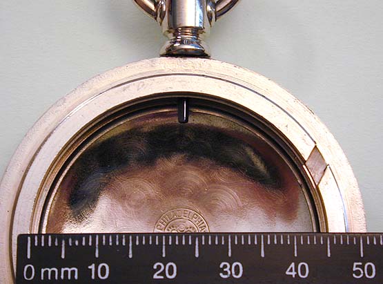

John, your case definitely has that "unused but slightly shopworn" look to it. As I said above except for the "Imitation Silver U.S.A." it looks like any other Phiadelphia 18-size open-face case. But again, the exact lever position may vary with different watch movements.
Perhaps the image below which is of a similar unused case in my collection may be of help. You'll see the 18-size case has a 45mm opening on the front side. You'll find the last three or four digits of the case serial number on the frame edge and bezel.
Below a similar Philadelphia nickel case to compare...March 13, 2006, 16:13

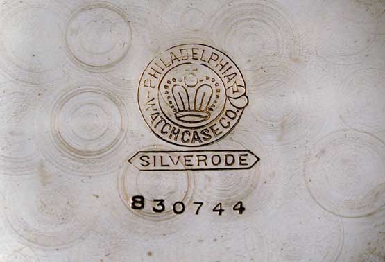

Here are the inside-back markings from the case shown in the image directly above this post. This one is a standard 18-size Philadelphia case in nickel. It will take most any 18-size but as I pointed out earlier, carefully check the lever position carefully unless you're comfortable filing the case-slot.
Case maker's signature from the one I shared above...March 13, 2006, 18:19

Terry HillThat is an interesting marking on your case John... and I too believe it had to do with the exporting of the case....
and it appears there are no CS marks....
