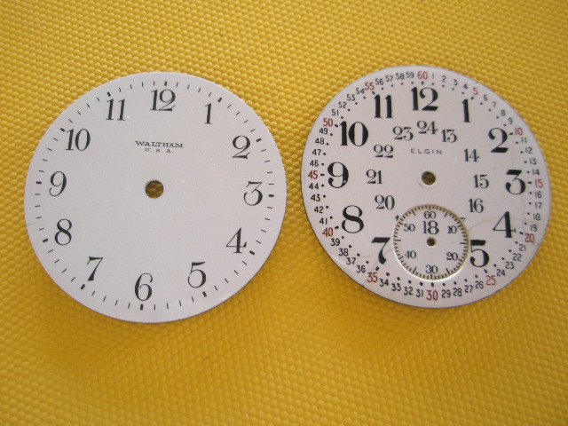

2 dials need help.
I have those 2 dials and would like to know on
what watches they go on.

Peter,
What are the dial feet location and size (12, 16, or 18)?
April 02, 2013, 15:20
Peter Kaszubski
dials are size 16
Waltham dial feet at 3,23 and 43 min.
Elgin dial feet at 19,36 and 55 min.

Jon Hart

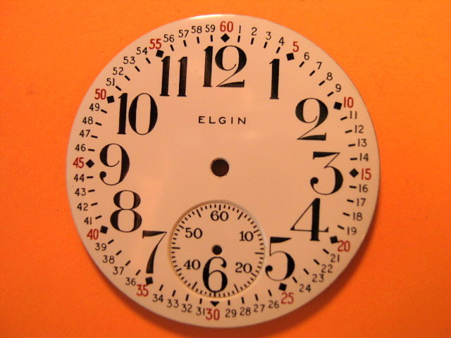

The Elgin could go on a BW Raymond 21j 3/4 plate or pretty much any Elgin 16sz with the standard (19, 36, and 55). It has the Canada 24 hour going for it.
Here is the standard Elgin monty - I have sold a few of them - they look nice and are reasonable in price when compared to a Hamilton monty

Peter Kaszubski
but the waltham is missing the seconds hole.

Richard M. Jones
I would guess the Waltham might fit on an Equity as I think some were produced without a seconds hand and I think they were largely lower cost export watches. Perhaps a Waltham collector has more knowledge?

Buster Beck
I believe those type Waltham dials were used for Waltham H/C movements to be put in an O/F case and the 4th wheel pinion left off and possibly to export also.

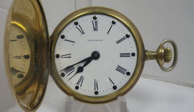

Eugene Buffard
Here is a Waltham with no seconds pinion. Yours does not have embossed Numbers though.
This Braille watch of mine is on eBay right now for sale.
