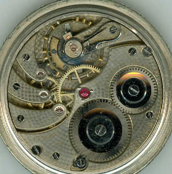

Hello,
I have a private label watch, which may be a Waltham but I'm not sure.  The markings are "CB", "17 JEWELS" and "J.O. PATENAUDE NELSON B.C."  Serial number 2766480.  Further back in the movement it is marked SWISS but as I'm new to the hobby, not sure if this is significant.  Image attached.  Thanks, Chris Boyer, Waterloo, Ontario, Canada.

Bill MandersHi Chris,
No expert, but looks like it could be either A Omega "Regina" or possibly a Longines movement.
I'm sure others will chime in here for a definitive answer.

William ThomasMost likely a Longines. Commonly seen as Canadian private label movements. The spotted finish is a give-away. Would be interesting to see what's under the dial.
