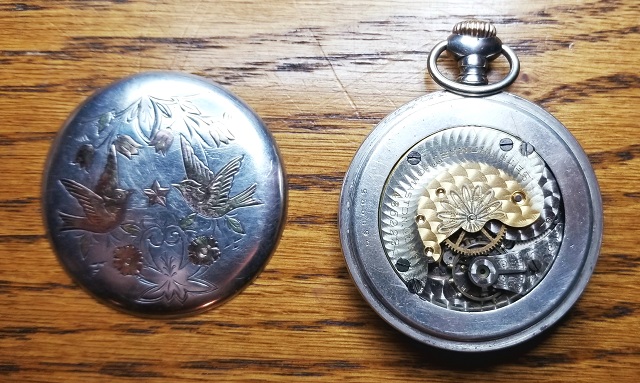

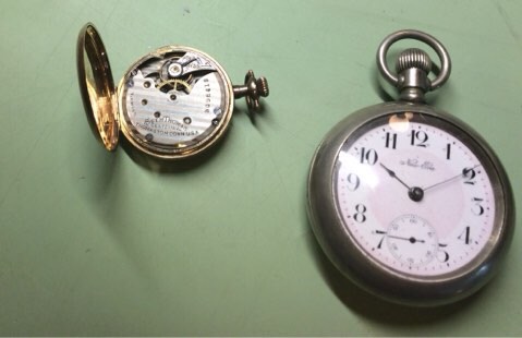

Joseph BlossicMike, Rick, would you guys mind posting a clear close up of your respective watches?  I have some unidentified movements and thinking they might be Seth's like yours.  Thanks!  Joe
July 11, 2018, 15:59

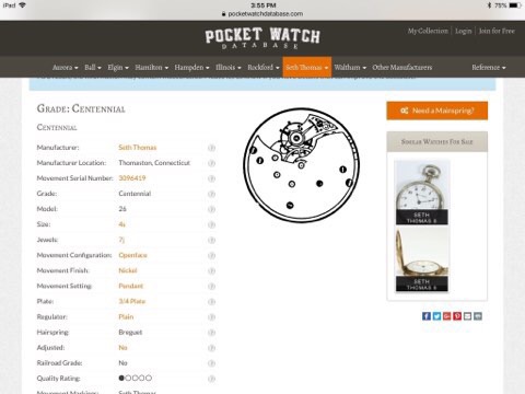

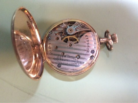

Mike BendaJoe
The Seth below is on the database.
Mark is good about that.

Joseph BlossicThanks Mike for the pix and the tip!  Joe
July 13, 2018, 00:03
Joseph BlossicThanks Rick, that is a nice one!  I appreciate you posting.  Joe
