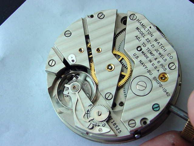

Samie L. Smith
nice looking movements 36 size

John W. Clark
Interesting watch... I was looking at the balance wheel (totaly different from any 992 that I have seen) which appears to be solid and begs the question How do they maintain temperature stability? If I am interpreting the screws on the balance properly the MT screws seem to be offset from where one would normally find them they are neither at the balance arm ends nor at the quarter position. Is this positioning a result of being a solid balance?
