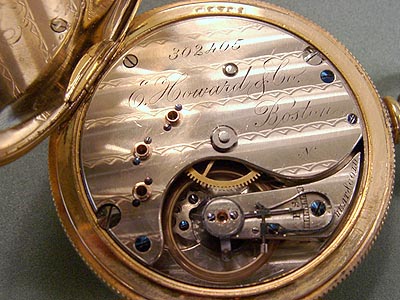

I am hoping that some of you pocket watch enthusiasts can give me some information on this old Howard. I believe it is a model VIII 18 size 15 jewels.
I know the case is well worn and the nickel bow is not right. My memory tells me that Howard’s of this type had to be in a special case? I have a full set of pictures and would appreciate all the information I can get.
I know how to fix them but have always concentrated on wristwatches. My knowledge on Howard’s and there history probably could not cover a pinhead.
This one has some incorrect screws some polished and some blued. I think they should be blued from this era is that correct.

Harold VisserHello Rich, your watch is a series VIII one of 8420 made. It was finished March 3,1887 and is a Grade #5; Adjusted to Heat&Cold and Isochronism. One of the non blued pillar plate screws is wrong, but the case screws appear to be correct. The E. Howards do require a case specifically made to fit a E. Howard movement. Most Howard collectors shy away from a gold-filled cased Howards myself included, but I have seen numerous ads from that time frame that offered gold-filled cases for a movements like yours. Normally a re-cased watch would show a stem detent screw in the pendant, a Howard has the screw in the movement, or a cutout for the lever set would be another clue that it's a recase. Your example shows neither of these. Does it have the movement dust ring present? It appears to fit in the case properly, but without holding it in my hand, I can not say for sure whether or not it is an original case. The case screws do not appear to screw down on the ledge properly, but then again it's hard to tell from the picture. Is there any evidence of extra case screw marks? That's about all I can offer you, hope it helps.

Rich KuhnHarold,
Thank you for the information. The movement does have the dust ring and I see no extra screw marks on the case. I am quite sure this case has not seen another movement. I have had the movement out of the case but have not had the movement apart so I don't know if anything is wrong under the dial. It runs well, keeps time and sets properly so I have not cleaned it.

Rich,
You might want to ask Harold or perhaps Ray Tyulty about finding the blued, dome-top screws you need. They'd improve the look of the movement tremendously.
