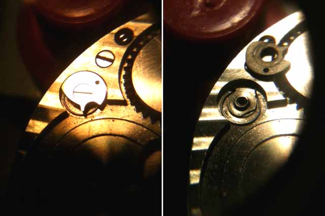

Now on to the next fix required. The click will not engage the winding wheel. I have check and the spring is there. Could it need a new click spring or am I missing something.

The click springs on the 992Bs are pretty small if I remember. If there is no tension then it might have come out of the hole or be broken.

I am not sure. It could be gummed up or even perhaps bent. I just took one apart and took some pictures. It feels pretty loose even together, so I would take a look at yours and see if anything is stopping it, or gumming it up.

Keith check that the click is centered and the screw holding it is tight.
Also has the movement been serviced? There could be dirt under it, OR, someone could have bent the spring just enough that it will not pull the lever back the way it was meant to.
If that is not the case I just may have one for it.

Also, your spring may have lost its "spring-back" tensile that makes it work correctly. Sometimes these get bent out of shape and then when bent back over time they sometimes lose their "set" of the spring steel and don't work as intended.

Great pictures of the click spring !!
