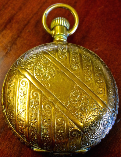

Here's an 1889 Elgin G.M. Wheeler, 18s, 15j, OF, PS in a nice looking (but completely unmarked, except for a serial number) case. Dial & hands look excellent (are they both appropriate?). The movement looks a bit plain, to me. Does not run (broken balance staff).
What do you think of it? Would you fix it and use it? It has the usual family history, sentimental value, etc.
Three images - first the front:

Elgin 1889 back:

The case is likely a second "home" for the movement as the (1888) age would suggest the first case wore out.

On the case - I guess I'm interested in the fact that I can't find any markings on it at all, other than a serial number. With a watch this old, I just assume that it's a "re-case" unless someone makes a big point of claiming that it's not. But, I wonder about the complete lack of brand/model/anything - other than a case serial number (of course, they all match). In case it's not obvious from the few photos I posted, this is 3-hinge, with a nice gold-looking cuvet. My experience is severely limited, but I've never seen a case like this with no indication whatsoever of who made it. In all the other cases I can dredge up, I think I have assumed in the past that the case was made (supplied...) by the manufacturer of the movement.
I'll ask about the family history - in particular who wore it and for how long. Given the condition of the dial and case, these are either replacements or a sign that it's been sitting in someone's jewelry box for a very long time (perhaps after the first time it was damaged...and never repaired?) To my (unpracticed!) eye - the condition of the case is consistent with the condition of the dial and hands. Meaning...what? That they are either all original, or all replacements?

The dial and hands look original to me, or are at a minimum correct. Pre-1900... I would expect to see a screw in the neck of the case to retain the stem.. but, this was in that transition period where either could be correct.
I've had a couple of unmarked cases. About this time, there were some brass cases on the market. These cases are interesting because the ones I have are very ornate and the brass holds up extremely well to wear and tear. They are not gold, but look ten times nicer than a similar 20yr gold case that is all smoothed out and brassed.
If the covet appears to be "gold filled" but the case appears to be brass... it is likely the case is one of the early "gold plated" cases... or a 5yr case. I have a couple of these where the outside of the case appears to be all brass... the gold is completely worn off... but on the inside it looks like a gold filled case.
