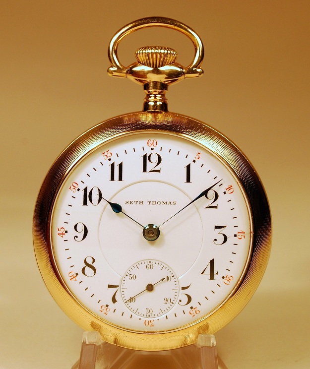

My gorgeous 24j Maiden Lane was procured at a domestic auction house a couple of months ago. Seth Thomas apparently blocked out a total of 160 serial numbers for this grade, evenly split between straight nickel and the two-tone variant pictured here. That means this watch is one of only 80 ever produced.

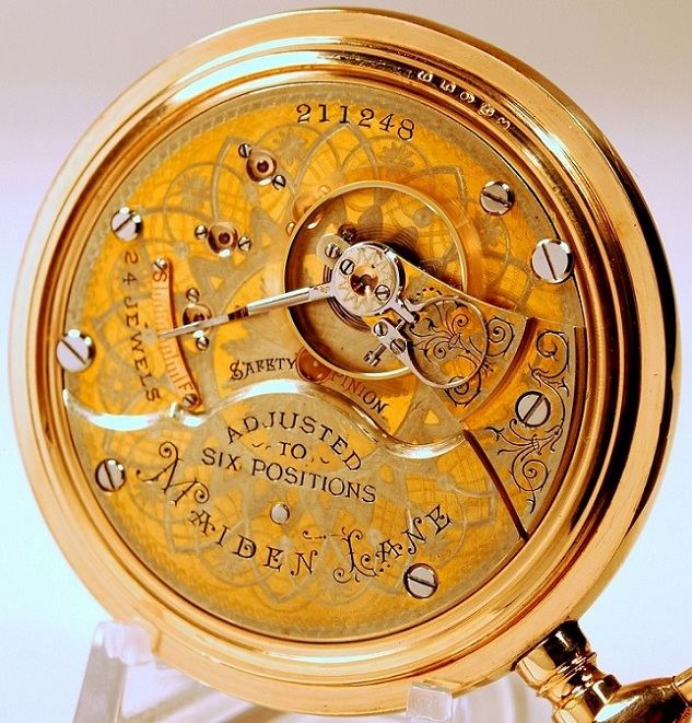

It was damaged by previous "repairs" to the point where it would barely run, let alone keep time. The balance wheel was out of round, the upper and lower jewels had been replaced, the staff was too short, and worst of all, someone had used pliers to bend the balance cock down to accomodate the shorter staff.
But all the serial numbers matched.
April 05, 2011, 17:49
Eric Unselt
My reprobate Amish watchmaker went to work.
First he trued the balance wheel, re-staffed it, vibrated the hairspring, and replaced the damaged jewels. He had to fabricate new jewel-setting screws to match the rest of the plate screws.

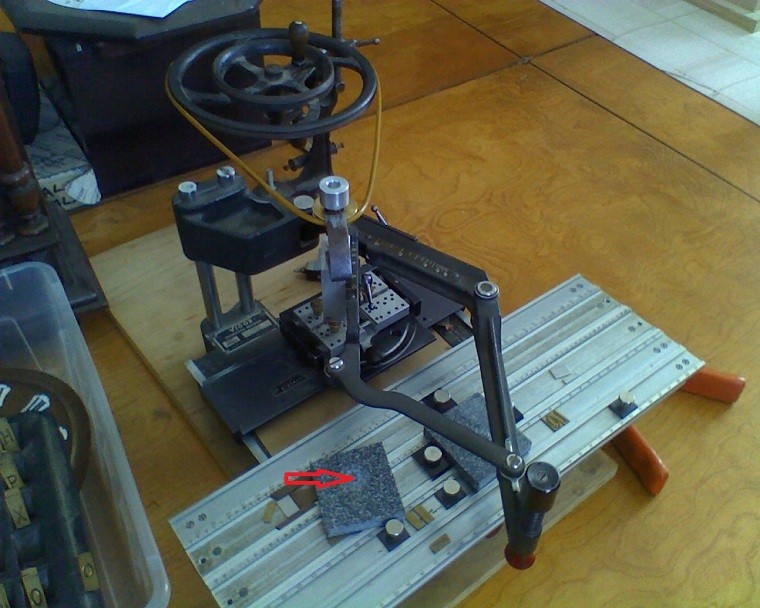

But the plier damage to the balance cock? After straightening it on an arbor press, he re-lapped the plateau, removing all but the deepest gouge marks. Then using the hand-cranked pantograph you see pictured here, he re-milled the original 12-point star pattern. He hand-carved several templates (red arrow) out of Corian, and did a few dry runs with each before he was satisfied with the results.

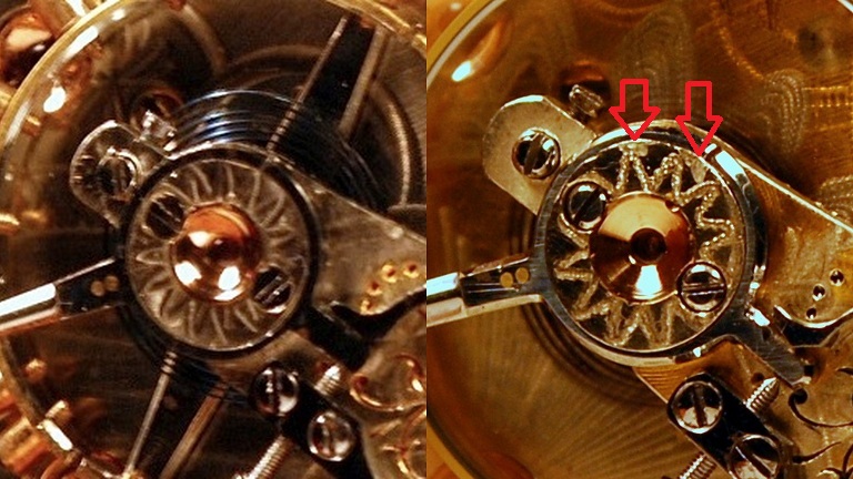

The balance plateau on the left is a factory original on another Seth. The one on the right is the rebuilt one on the Maiden Lane. The red arrows show the remnants of the plier damage. If he’d gone any deeper, the regulator whip wouldn’t have stayed on the plateau.

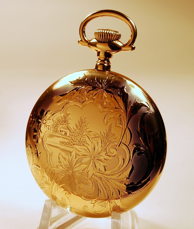

The Keystone case was damaged, too. Someone had filed down the ledge that the movement sits on to accommodate a Howard, which has a slightly larger pillar plate (the Maiden Lane could actually fall through the case frame). My Amish man turned the inner wall smooth, cut a dado in the case wall, and fabricated a steel snap-ring to replace the missing original.
April 05, 2011, 17:55
Eric Unselt
This is the result of nearly 30 hours of labor, many of it done by lamplight, and on a foot-powered lathe. He even fabricated the matching beveled case screws to replicate the originals. You can believe that it now keeps Stoner time.
