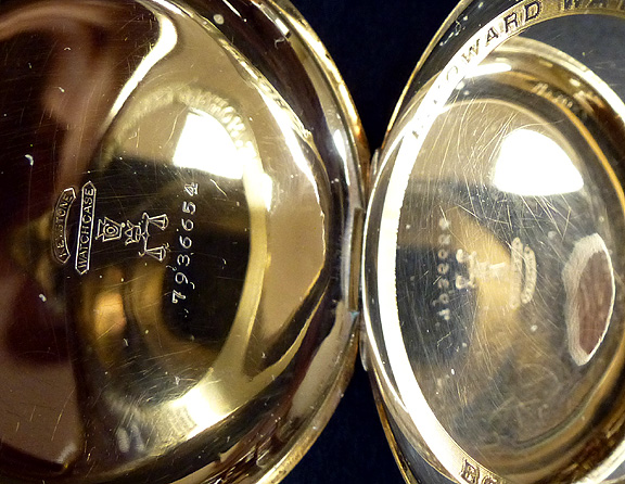

Here is the inside cuvette from a No. 1035 although the movement is a No.10 rather than Series 10. The Howard Watch Co. circle is on outside of the cuvette but for some reason don't have a pic.
August 28, 2012, 13:13
Lorne Wasylishen
And inside the outer cover.

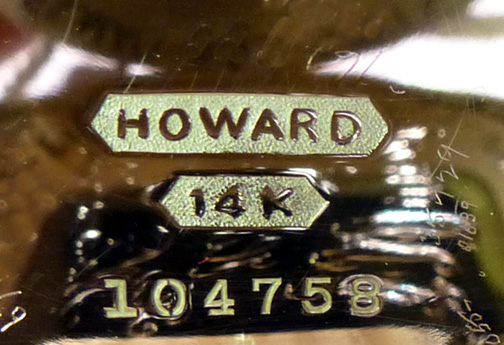

Lorne,
Would you say that 14K case/logo was made by CCWC?
August 29, 2012, 02:17
Lorne Wasylishen
You know Mike I never even thought about that and wouldn't even hazard a guess as it would be based on nothing. Anybody else have any input on this?

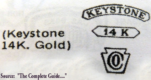

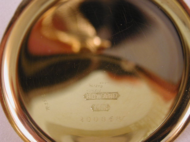

I looked in "The Complete Guide..." for solid gold marks and found the following logo. Based on shape of the mark and Howards relationship to Keystone, I would say your case is made by Keystone.

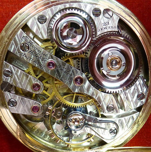

I also have a similar case on a very early Keystone Howard, and so will show 2 pictures to follow.....
August 29, 2012, 21:36
Mike LaForest
....first the gold mark on the case....
August 29, 2012, 21:53
Mike LaForest
.... and then the 23J movement (SN 953059) in the case. This unmarked, Series 0 movement, was in the first run of Series O watches produced by the E. Howard Watch Co. Note he criss-cross damaskeen pattern.
