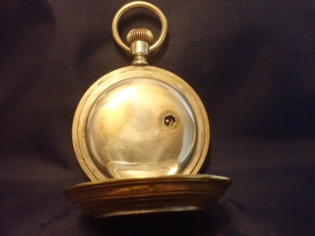

Unfortunately, I don't know if the case originally came with the watch, or the dollar coins were added later. I never run across any pictures of an identical watch. There is nothing on the case which I can identify as to the manufacturer. On the inside cuvette, there's a 'K', followed by a 75 and a 2 with what appears to be an overstruck 4, and followed by what looks to be an upside down 1.

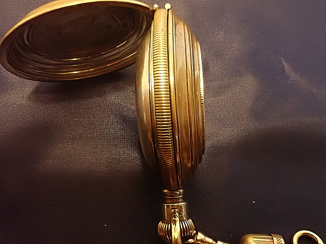

The case color looks to be 14K and the case is finished in coin edge.

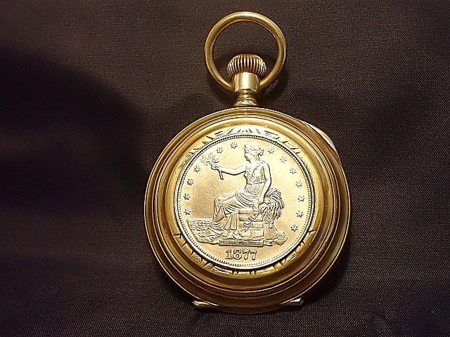

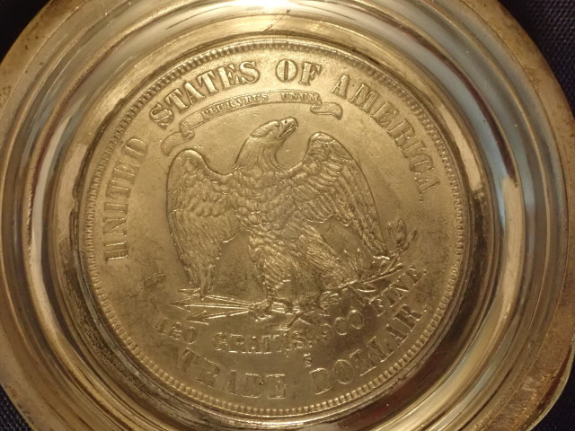

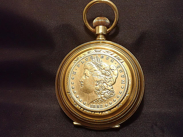

The front coin is an 1882 Morgan silver dollar with a San Francisco mint mark. The rear coin is an 1877 US trade dollar with a San Francisco mint mark. Trade dollars were only minted for 1873 - 1878. I'm thinking the 1882 dollar was chosen for when the watch was purchased - manufactured in 1881, and the 1877 dollar was chosen for the model number.

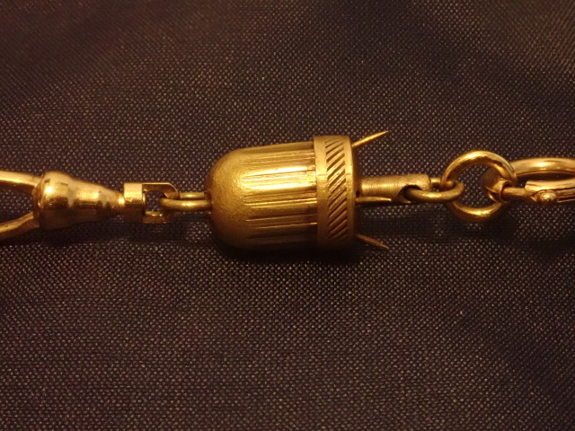

The antitheft device is quite large, about the size of a small acorn - much bigger then the two Nelco's I have. I've been unable to find the manufacturer.

Mort DenisonCase markings - on the cuvette

Kevin HoffmanI like the antitheft device , that alone has some value ,nice watch

That thing is truly massive. I remember this being here for a new crystal and for these large key set watches where the bezel must be opened and closed each time the time is set, I try to use 0.9mm glass instead of the much thinner 0.4mm that I normally use on 16s and smaller hunting cases. It's many times stronger and there is usually enough room under the cover of these big cases to accommodate the thicker glass. I have a question though. What the heck is an anti-theft device and how does it work? Do the 4 spikes come out and impale the thief's fingers when he/she tries to yank the watch away from the owner? Can these spikes be treated with a toxic poison that will cause instant debilitating illness/coma/death? Someone please educate me on this strange and medieval looking device because I've never seen one and I'm very curious.

I guess pocket watches were a prime target back in the day. The antitheft device resides in your pocket with the 4 prongs retracted. When someone pulls on the chain, the prongs come out and snags in your pocket. You have to grab the watch and pull it out of your pocket instead. Sometimes a prong will alert you as it catches on your skin if you try to use the chain. It's a bit painful. Ask me how I know.
The smaller Nelco device shows up on eBay a couple of times a year. I've got a couple for my smaller watches. This larger one shows up very infrequently. I wish I knew who made it.

Now I understand. Quite a clever solution! Thanks for explaining.

Can you tell how the coins are mounted?

Back to the coins.
As far as I can tell, an extremely precise hole was cut in each cover. It appears, perhaps, that silver solder was used on the rim of the hole. Then the coins were placed in the hole while the case was heated. There was no damage to the coin edges and the soldering is almost not visible.
Purely conjecture on my part.
