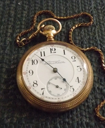

I'm a sucker for script signed dials and liked this distinguished case. When she came in, I was a bit disappointed that the jewels had flea poop all over them and the mung in the edges of the double sunk dial had to go. That is also when I figured out she is pendant set.
Not sure what I had and not sure I wanted to risk opening her up, I took the watch to Dave for his assessment. I got plenty of affirmation on finding a nice piece and left my new girl with the pro's.
Earl did a great job of detailing every nook and cranny. I happened by to check in just in time find Dave making the timing adjustments. He showed me how the main screws were already dialed all the way in. Then he put her on his magic syncopation machine to show me how many beats slow she was running.
Dave proceeded to remove opposing balance screws and put them on a nifty little gold hogging machine. One turn, two turns and another half turn for good measure each. Now a couple milligrams lighter, he returned the screws to their homes in the balance wheel and put her back on the syncopation machine. When she came up to 18,000 and settled down there, he just looked over and gave me a simple smile.
This is great fun. Thanks to all for bringing me along.

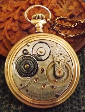

And the movement

And a picture to show the Commander 14ct gold filled guaranteed 25 year case was never cut for a lever.
