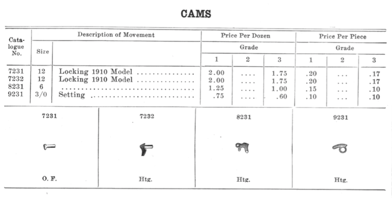

Michael - Does the part you are referencing match #7232 from this Hampden Material Catalog?

Nathan, it looks like part# 7232. Where can a body get his hands on that parts catalog? Thanks

Here is the "Cams" section from the 1915 catalog:
https://pocketwatchdatabase.co...al-catalog-c.1915/33
