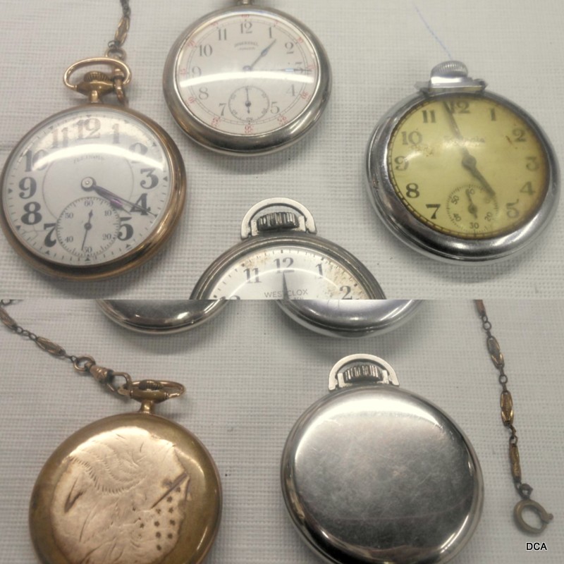

Recently our new member Dave Turner asked me about an eBay listing. It looked to me like someone was cleaning their drawers or something. But . . . then I saw a D.S. dial in the mish-mash and suggested to Dave there was something there worth a small (under 100 bucks) gamble. Dave "took the bait" and won the stuff for under a hundred bucks.

When Dave received the watches he wrote; "Dave,
I've been carrying the Illinois for a couple of days now and it keeps almost dead accurate time. Might be 5 or 10 seconds slow in 24 hours. I notice when I wind it it's easy to wind for the first 13 - 15 turns, then gets real hard to wind. So, it only runs for about 12 - 15 hours."

That Bunn is looking good! Can't wait to get it back.
By the way, those other two watches in that group purchase are now running too.
The Ingraham St. Regis:
The balance wheel was floating loose in the frame.
The Ingersoll Junior:
Had one pin missing in the pallet fork. And Jack Marsh graciously sent me a replacement fork. I broke the hairspring in the process of repairing it, but now it's ticking away, (runs a little fast because of the short hairspring, but I think I can adjust that out with the regulator).
Thanks to all of you for your help.

Dave Turner
Just received the Illinois Bunn back from Dave Abbe.
Man, was I surprised! What a transition, can't believe it's the same watch. This is my first Illinois!
