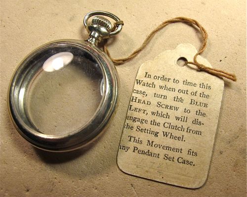

Since this discussion is concerning Os Hamiltons, I figured I would share this with you guys. I've never seen a factory display case this small before, but it appears to be legit and was meant for an Os Lady Hamilton. I'm not much into Hamiltons, so I don't even know what a Lady Hamilton is.

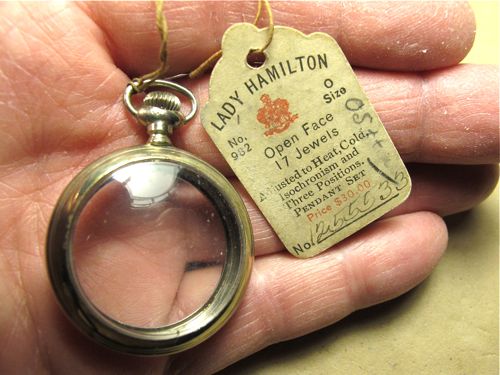

Bruce Stewart
This shot shows the front of the tag.

April 15, 2013, 14:32
Hub Harms
Bruce
Oops though tag said $10.
April 15, 2013, 16:36
Bruce Stewart
Hubert, I didn't even realize there was a price printed on the tag...it's kind of hiding there at the bottom in faded red ink. $100 is a real strong offer, and I appreciate it, but not really looking to sell at this time. If I do sell (auction style), I'll be sure to let you know. Smile
April 16, 2013, 01:45
Hub Harms
Hi Bruce ,
Pease let me know If you are going to part with
case.I have a O size Hamilton that will fit.
Hub.
April 16, 2013, 09:44
Bruce Stewart
Hub, will do.
