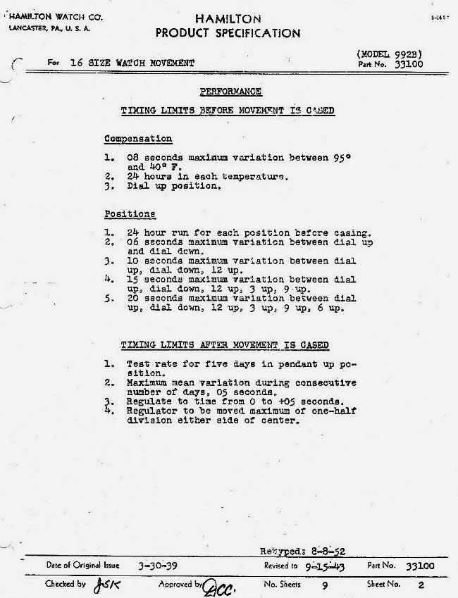

Robert Sweet sent us the 992B Specifications he posted...

The sixth postion adjustment is very difficult and actually comes at the cost of the other positions. The reason has to do with the inner terminal of the hairspring where it attaches to the collet. When the balance is at rest the hairspring should come out of the collet and head upwards. This is toward the stem, when stem is up on a open face watch. When you have the stem down, then the hairspring comes out of the collet and heads down, causing a terminal end error.
You can compensate for a terminal error by creating some positional error in the opposite direction. So you are giving up some accuracy in positions that are most used to get less error in a position that you hardly ever use.
Look at the Hamilton standards that Robert gave you for the 992B. Notice that a 10 second range was allowed between any of the first three positions. This really means 10 seconds between pendant up compared to the dial positions. This rises to 15 seconds when we add the pendant left and right positions and 20 seconds when we add the pendant down position. So the adjusting is still oriented to get the best timing in the most common three positions.
Here are the 992 standards:
Six seconds between dial and cock positions.
Ten seconds between all five positions.
See that the 992 was actually adjusted to better timekeeping over the five positions (10 versus 15 seconds per day). No standard is reported for the 6th position for the 992, but we know they gave up 4 seconds on the pendant up and 5 seconds on the pendant left and right positions to bring the pendant down position to 20 seconds on the 992B.
The important thing about the 992B is the great reduction of the middle temperature error. A compensated balance with a steel hairspring was adjusted to keep good time at low and high temperature. This created a middle temperature error. So a watch that is right on at 50 F and 100F, would run fast by 4 to 5 seconds at 70F. The effect was even larger for higher and lower temperatures. With a Swiss Elinvar hairspring the temperature error was only about 1.5 second from 40F to 120F, and most of this was at the very high temperatures. I believe the error was even less with Elinvar Extra. This is a huge improvement.
So it is not enough to say a watch is adjusted to six versus five positions. The question is to what tolerances. How is the watch going to be used? A Hamilton Model 21 chronometer was not adjusted to close positional error, because it was expected to run dial up only. It was gimbled to do so. There is no better mechanical timekeeper, but it would keep terrible time pendant up.
The 4992B master navigational watch, which is essentually a 992B, was adjusted to within 5 seconds over the three positions (remember the 992B was 10 seconds over these positions). This was because the watch was expected to be kept mostly dial up and sometimes pendant up. I am sure the 4992B would not pass the 992B standards in the three positions. You improve things in some positions at the expense of other positions.
Finally, I must repeat that all of this positional error stuff means nothing for a watch that has not been factory adjusted in decades. You can adjust a 992 to 992B standards and visa versa. You can even adjust a 974 to 992B standards if you know what you are doing and have several days to work on it.
You cannot get a 992 to have the small temperature error of a 992B, no matter how much adjusting you do. Steel cannot perform like Elinvar.

Don,
Thank you very much for sharing the 992 specification and all the other great info.
Robert

Agreed, great information! I was especially interested to learn that the 4992B and 992B were adjusted to different specs and the model 21 chronometer also. GREAT stuff and thanks.
