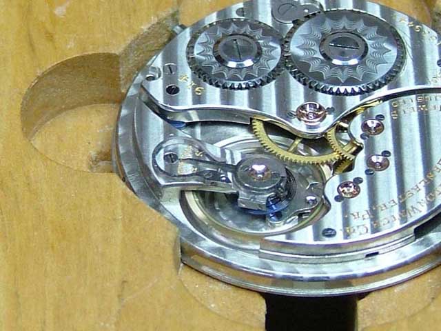

I have a Hamilton 12s model 914 that has a broken regulator screw. Is it possible to remove and replace the screw and if so where can i get a replacement? Thanks..Paul

Paul please post a picture of the spring with the screw in it. I have screws and have replaced these if there is enough of a "stump" sticking out

David: Here is a picture of the broken screw. Hope this shows what you need. Paul
June 11, 2011, 11:58
Paul, I have fixed that situation before and have some extra screws. It requires disassembling the spring from the balance cock, and using a micro-chuck to unscrew the stump past the spring, then installing a new screw (I have some) and re-assembling the spring to the balance cock. If you want to send it to me, I can do it and return it to you.

Ater receiving and fixing this, Paul asked; "Thanks again for the getting that screw fixed for me. I would have loved to see just how you did that. Paul" So here is a picture of "how I did it". Note: It takes a "real little" Watchmakers Balance screw holder.
