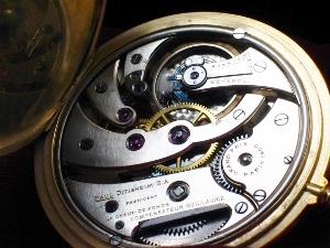

March 13, 2015, 00:01
Ethan Lipsig
Here is a Depollier Ditisheim with shock protection from my collection.

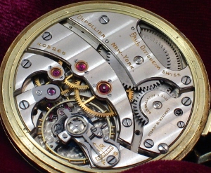

March 13, 2015, 00:02
Ethan Lipsig
And here is a non-Depollier Ditisheim without shock protection from my collection. This watch has other nice features, though.
