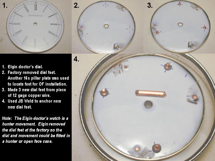

Elgin removed the dial feet on doctor's watch dials. They did this so that the dial could be fitted to the movement as open face or hunter.
Because of case fit problems, I had to make my own dial feet from some 12 gage copper wire. The picture shows the the dial feet attached using "JB Weld".

John D. DuvallSteve,
The dial would not "snap on". When I received the watch, the only thing holding the dial in place were the hands.
To complicate matters more, the case did not have a lip area to catch pillar plate. The dial rim would catch on the case and with dial feet to connect the dial to the pillar plate, I was able to secure the movement in the case. The JB weld came loose on two feet due to the tension stress even though the case screws were lightly torqued.
Although the case appeares to be original, I can't see how they kept the movement in the case. I'm currently looking for a replacement open or hunter case for it. The current case will not hold a 16s movement. The movement is all original with matching plate numbers and balance.
Any ideas Steve?
As I said, the screws were never really torqued down as you would normally, just seated enough to keep the movement from flopping around during winding. Yes, you are correct, it is a good way to crack a dial.
I believe the case is a 14k gold filled J.Boss (crown & scales). It has a hinged front bezel and hinged rear back and cuvette. The diameter where the lip should be measures 43.17 mm. I measured some other 16s cases and the diameter of the lip ranges from 42.27 to 42.58 mm.
The male stem is integral to the movement with the female sleeve in the pendant. These cases are somewhat difficult to find. I don't have another Doctor's watch to compare this one to so I don't know if there was a tiny ring that was used around pillar plate to help capture the case. Even if the dial would snap into postion, I doubt that you could torque the case screws without popping it off.
Does anyone know the diameter of the pillar plate for a 17s size watch and did J.Boss make a case for a 17s watch? All I know is that an Elgin 16s movement of this vintage will not fit in this case. Maybe I have one of those rare cases that fit nothing.
This case was not modified either. I guess it was my luck ending up with a case and movement dial that were both factory botch jobs.
