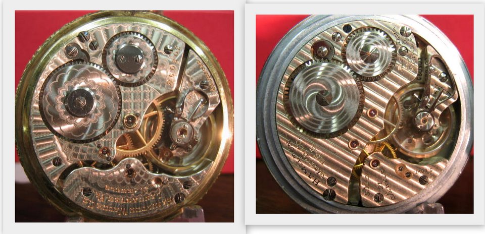

Materials such as Elinvar balance springs, white steel mainsprings, and solid balance wheels are reported to be the main difference.
While these do spell some "difference" in the anticipated quality of timekeeping, the quality of FINISH of the movements did (in my humble opinion) deteriorate significantly. The one on the right is a 992B

Thanks David for the info what one did you think keep better time of the two when they came out of the factory brand new and were a better made watch.
December 31, 2008, 12:08
Steve Middlesworth
I would have to agree Dave, the 992 is a much more beautiful finish and would require a great deal more time to put the demakeening on. I would have to assume that the bridge plates would all have to be installed onto the pillar plate and done at the same time before any assembly work could even begin. What a gorgeous timepiece that 992.
