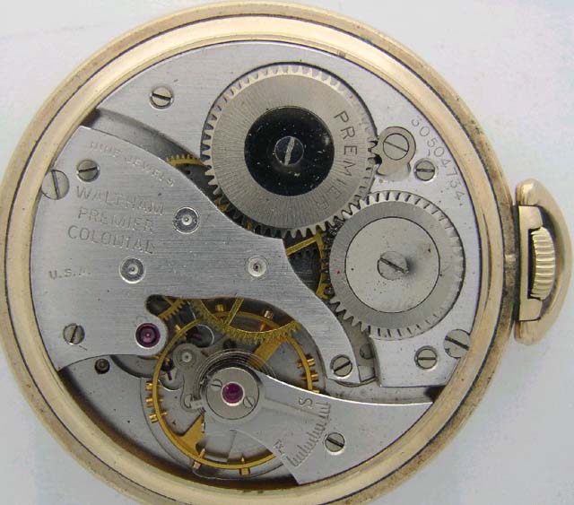

Have a small Waltham pocket watch, S/N 30504734, marked on the movement Waltham Premier Colonial, setting P S, and the pillar plate measures 39.60mm approx. The Ehrhardt Waltham pocket watch guide list the size as COL, was wondering why they might have used this size designation? Also wonder what the letters P S indicate in the setting? Thanks for any information.
April 20, 2003, 10:56
Ed UeberallWayne,
The Waltham Colonial series movements will not fit into a standard 12 size case. The "Col" designation alerts collectors that a special case sized for these movements is required. The "PS" indicates that the movement is pendant set, as opposed to lever, pin or nail set.

Wayne C. AndersonPhoto of the Waltham. I thought it was unusal to have Nine Jewels.

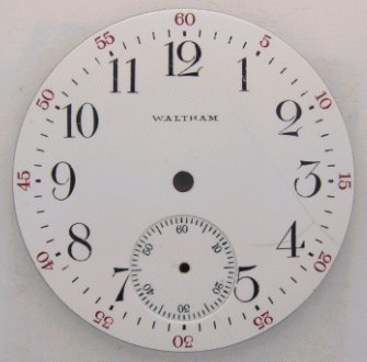

Wayne C. AndersonI have one Waltham Colonial with a metal dial, and the second one (S/N 30482354) was found with an enamal dial - wonder what type is correct for Nine Jewel, Grade No. 209 N.S.?

Lindell V. RiddleI would defer judgement to Ed or a Waltham expert, but my belief is that any dial that would have been available at the time of manufacture and fit the movement could have originally come on your watch.
That's the criteria that I have been using. When in doubt my source is period advertising and other such materials.
With a leaning to porcelain of course!Lindell
April 20, 2003, 15:55
Jerry TreimanWayne, your watch is fairly late and would have had a metal dial. It is a 1924 model Colonial, also known as a Colonial B. The enamel dial you show looks like one for the Colonial Series watches (different model) and would probably not fit your movement (the dial feet might be OK but the diameter would be wrong). [On the other hand, you might have a standard 12-size enamel dial there, which might fit but would not be appropriate.]
