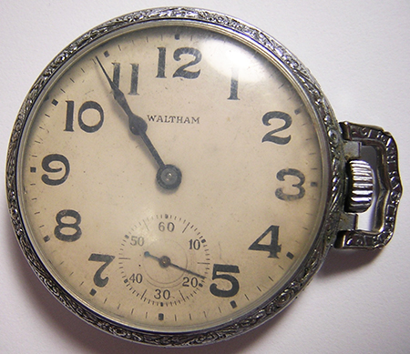

I'm back again with what will probably be my last new purchase until I sell some things! This just arrived today. The auction only had a picture of the front and back with no other information. I took a leap and this is what I got.
If my real quick research is correct, I believe it's a 16s Waltham from around 1903. As always, any thoughts or comments are appreciated.
The first picture is of the front. I didn't get the crystal off until after the pics were taken. Crystal is plastic and the dial looks to be painted metal.

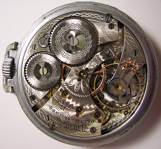

Here is the movement. Serial # is 12880895.

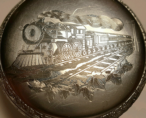

Here's what really sold me. I had no clue what the case was, but the train looked amazing.

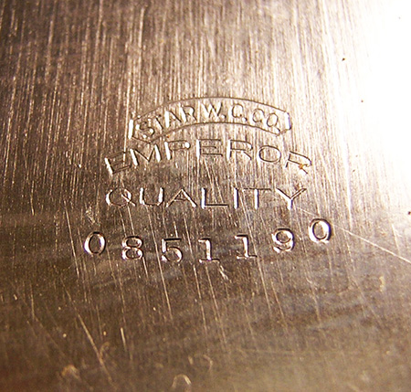

Inside case. The very bottom of the case actually says the words "Base Metal" with a tiny, little star beside it.

Here's my take, for what it's worth. The case and movement both look good but obviously don't go together. If it was mine, I would look for a nice, high pendant, Hunter case for the movement and use your case on an open face movement dating from no earlier than 1925.
I like that case even if it is base metal.

The main thing you see here is the fact that someone has put a H/C movement in a case that was made for an open face movement thereby creating the mismatch/hodgepodge/crossbreed, of what today is called a "sidewinder" because it winds at the 3 o'clock position.
The pendant urn cases were for the earlier watch movements such as yours. Around the early 1920's the urn went away and the crown sits right atop the mid section of the case. It was the wave of the future.

THe case in question is actually a model made around 1960 for people looking for a cheap base metal case as good cases were beginning to be scarce in the marketplace. It's not a case you would want to put a significant movement in. It's inexpensive, looks good, and serves a purpose today.

The metal dial we see here was repainted circa the 1930s going by the style of numerals.
We should also note that painted plain metal dials such as this one first came into use around the 1910-1912 era with the advent of 12-size movements. Metal dials allowed a thinner case which became very popular in the years that followed.
Waltham dials in Porcelain-Enamel such as originally came on this movement are readily available as many thousands of Walthams have been scrapped for repair parts.

You can tell something about the year a case was made by it's design. A 16s case with a long neck pendant could be from the 1890's up to about 1920. Shorter pendants came into vogue in the 20's and by the 30's, many cases had practically no pendant to speak of with the winding crown on or nearly on the top edge of the case. As has been said, the case you have, while very nice, was made as a low cost replacement for a worn out case and could contain nearly any movement that would fit in it. Nearly any 16s open face movement would be okay in it for a daily use watch. I just mentioned a Railroad grade one because of the train on the back. If having the watch wind from the side (the 3 o'clock position) doesn't bother you, then leave it as it is and enjoy it. It's still a nice watch.
