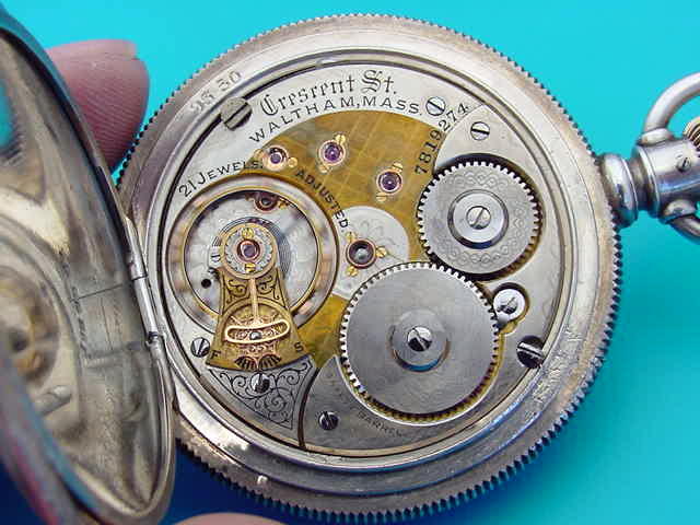

Joseph i have cleaned 2 of these in the last month i used # 111 L&R cleaning solution and # 3 rinse..I cleaned the jewels with pith wood ..then 4 minutes in the ultarsonic cleaner then i ran 3 minutes on the frist rinse and 2 minutes in the second rinse..I run more time than that on most watches i clean but with the jewels clean it dont take much time to clean the plates..One guy told me the only way he would clean the plates on a nice 2 tone was with a very soft brush which would work okay..
I use a L&r veri-matic cleaning machine
here is one i cleaned

Nice work and good advice Samie.
Charlie's comment about acid build-up is interesting and yet another reason to change the solution regularly.
