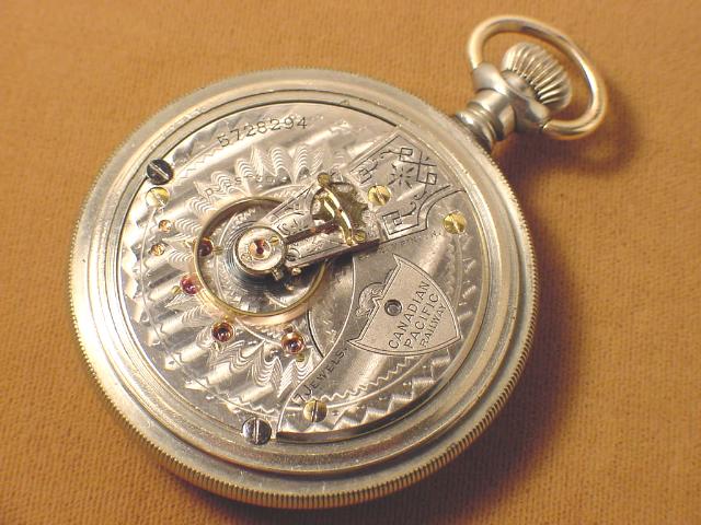

Hi all, i want ask a question about Pw.Waltham Canadian Pacific Rairoad. I see on web this Waltham CPR with serial number 5728294
http://www.horologist.com/gallery_8.htmBut, if i check serial number on database i not see CPR why? Is fake CPR? How i can know when is Real CPR? I know exist only 4570 Waltham CPR all serial numbers are here:
http://people.timezone.com/msandler/Articles/ClitheroeRailroad/cprserno.htmThank you!

David AbbeThis is listed as a 15 Jewel Pendant setting grade 35 model 1883 movement that is not particularly extraordinary. As some 15 Jewel movements of that period were marked adjusted as they were for temperatures and possibly isochronism, this may be (somehow) a legitimate watch, but it is very "fresh" looking. I would be very cautious with it for that reason. If you want to take the chance it should be checked for matching serial numbers.
June 15, 2008, 21:06
Donald TrumbleFrom the website description it is unclear as to whether the watch is available for purchase.  But I agree with David, if you are buying a 'Canadian Pacific' that name is the value so get the numbers confirmed.  While you're at it getting proof of the '17 Jewels' should be a no brainer!

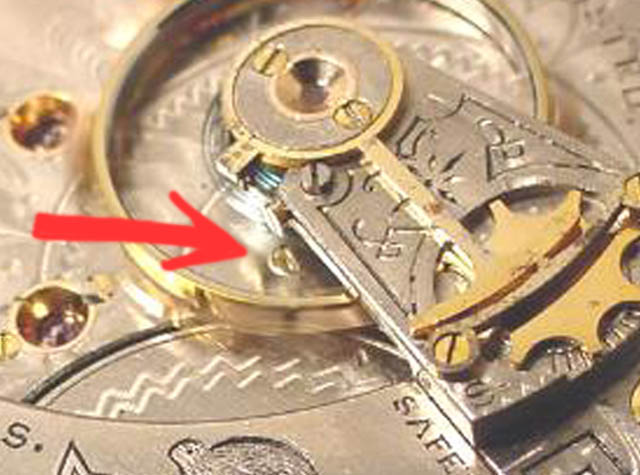

David AbbeI can confirm that is the 17th Jewel setting and screw as I checked the postions of those parts as shown below on an identical movement. btw a CPR just like this sold on eBay today.
