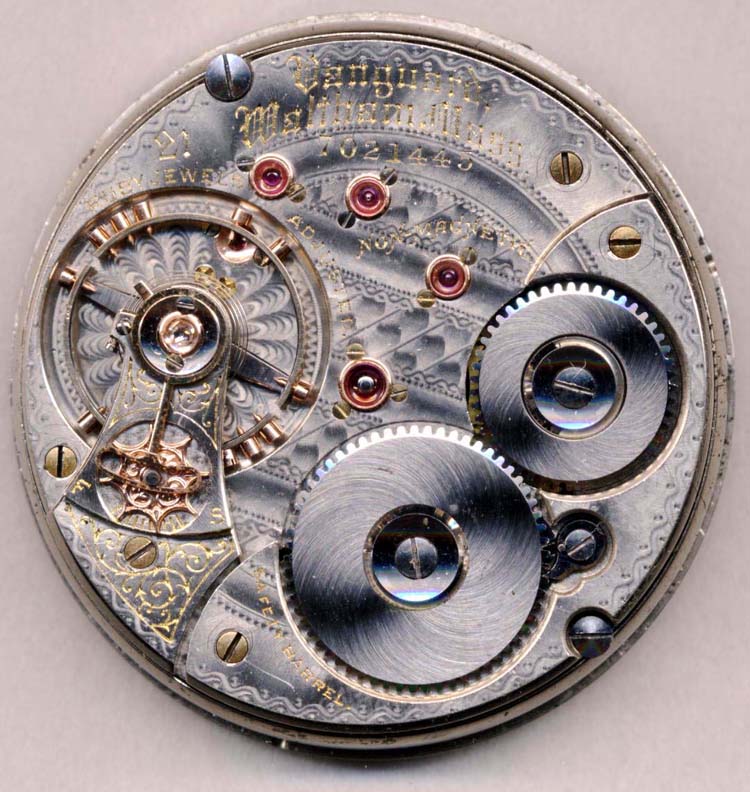

Jerry TreimanGee ... um ... does anyone want to see another Waltham Non-Magnetic movement? This 1888 model 16-size Riverside from 1890 is one of their earliest (note the marking under the balance wheel). I have a reprint of a Waltham booklet, dated January 1890, entitled "Information concerning a few points in the Construction of a Pocket Watch, also an announcement of a safeguard against one of the dangers to which it is exposed", the latter referring to magnetism. It is a printing of a lecture given by by E.A. Marsh. On page 41 it states that the company has been "since about the middle of 1887, constantly engaged in extensive and costly experiments, and with very gratifying success, so that they are able to refer to thousands of their new non-magnetic watches ... " Further discussion in this booklet mentions the metallurgical changes in the balance wheel, hairspring, roller, pallet and fork.

Bill CobbNice watch Jerry. Hey...as an experiment have you ever taken a magnet to it to see if there was any effect on it? Better yet, would it yank your pocket up against steel posts after you did?lol
