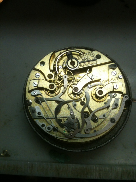

Need help ID Longines Chronograph needs staff
I bought this Longines and am needing help Id ing the movement so I can try to find a staff. Any info would be helpful.
It is 43.10 mm across the movement. It has a center chronograph with a 30 minute register.
Thanks in advance. Gene

Gene, You may have to have the staff drilled and re-pivoted.

Eugene Buffard
I can replace staffs. but what you talking about is beyond my expertise.
Do you have any one in mind.

Ray Hallenbeck
Gene, looks alot like a calibre 19.73, circa 1897

Eugene Buffard
I bought a 19.73 N staff. The piviots are a little big. But I can turn them down a little. I have not had time to pull the balance completely apart to check it to see if the dimensions of the new staff will work.
