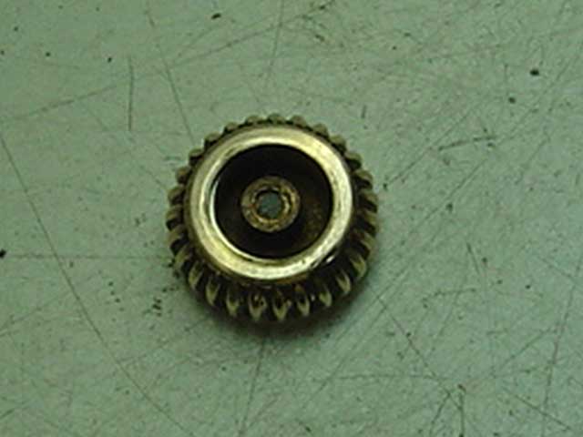

Excuse the large pictures but this is how Leon repaired a crown with a broken stem. This is how he received it.

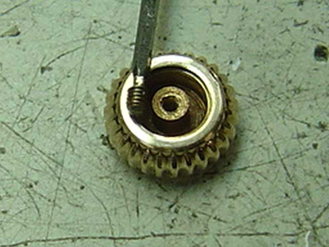

Steve Middlesworth
He then welded a square rod of some sort to it....

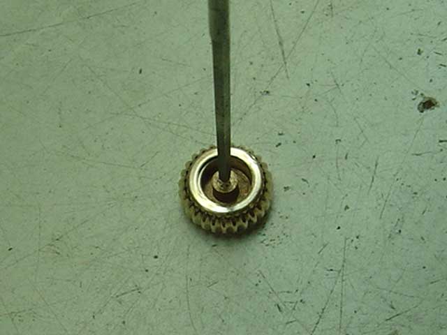

Steve Middlesworth
This is it with the square rod in it....

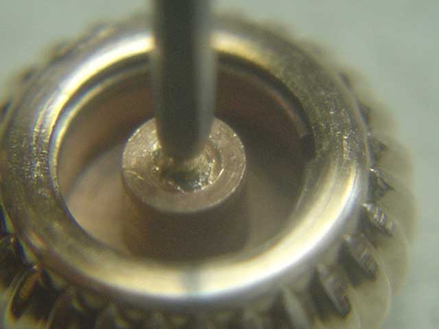

Steve Middlesworth
and walla....it can then be screwed out. Amazing workmanship.
