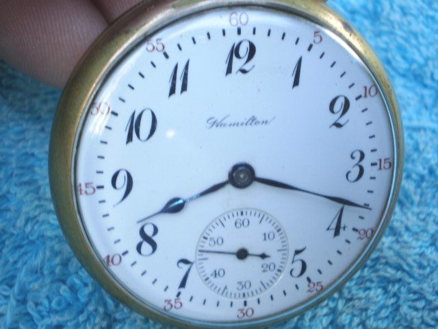

Can someone show me a period-appropriate alternative to moon hands for this 4-foot dial? The movement is a 990, SN 356452.
I've already got this combination of hands and dial on a 974.

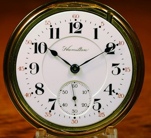

Edward Kitner
Eric,
I have noticed the majority of 16s Hamiltons, 4 & 3 foot dials, sport this style of hands.

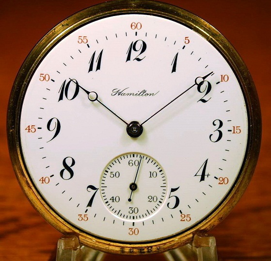

Claude Griffith
In the 1916 Hamilton Time Book pics there are light spade hands. The 990 would have had a DS dial. The minute hand on my 992 is correct, the hour hand while the spade is correct it does not ahve a swell near the base so it might be a replacement. The script on all except for the Electric Special dial would work.

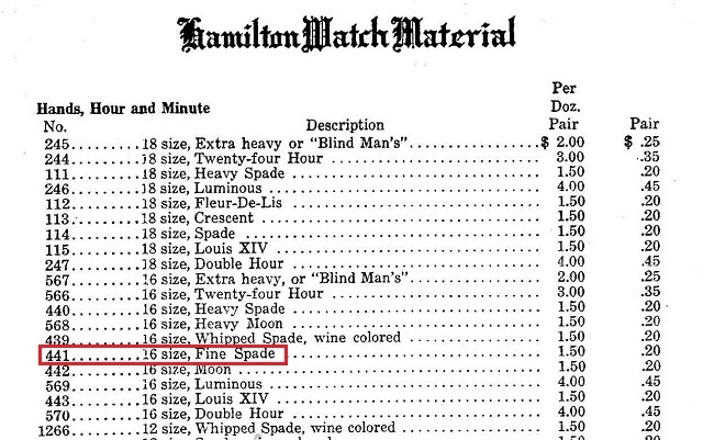

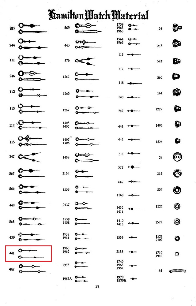

Richard Romero
Eric,
Fine spade hands appear in the 1920 Hamilton catalog.
RR
1920 Hamilton Catalog Page 16
April 01, 2011, 23:53
Richard Romero
1920 Hamilton Catalog Page 17
April 02, 2011, 07:18
Eric Unselt
That's what I wanted to see. Thanks, Rich.

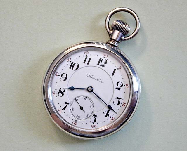

Eric,
I agree with Mike Hodge, every Hamilton 990 originally came with a porcelain-enamel Double-Sunk dial.
The one in my collection number 374629 is shown below this posting. Also, in checking the 1906 parts listing it confirms the hands I am showing you as correct. The style referred to as "fine spade" would be right for a lesser movement but the various dial and hands combinations for Railroad Watches were very specific.
Here is 374629 the 990 from my collection...

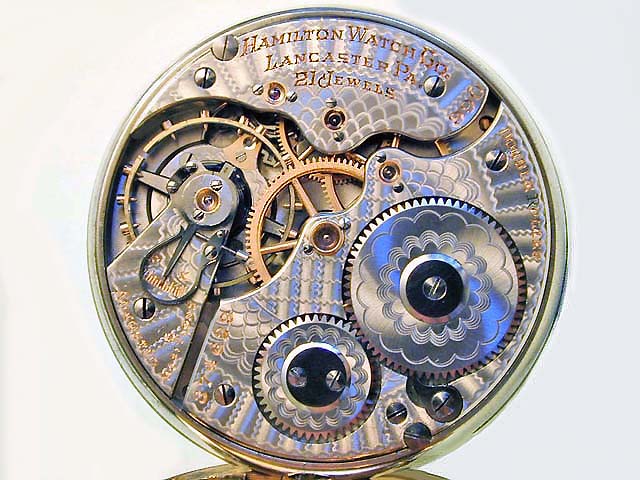

Just for fun, check out this 990 movement...

Eric Unselt
If I had a DS dial I would've used it already.
4-foot dials are scarce, and until I find one in my porridge the single-sunk one will have to do.
My question was simply which hands - other than moon - would be acceptable for that SS dial.
