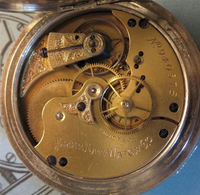

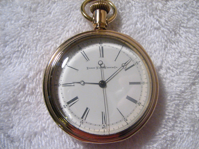

Chris Abell has restored my 1880 Elgin Doctor's watch No. 743074, which was a challenge.
J.Elgin
March 17, 2009, 13:39
John Elgin Cranfill
This Grade 83 is 15 jewel, 16 size, and was overbanked with a bent pallet, and missing it's sweep second hand--the main feature of the doctor's watch. Elgin made 3200 of these in 4 runs from 1879 to 1881, and this is number 274.
It now runs within 45 seconds a day after Chris did his magic, along with complete disassembly, clean and oiling.
I found 7 sweep second hands, but spade style instead of the proper moon style, on eBay and bought them for $45, mounted on an Elgin card. Chris used one of these for my watch and I gave him the rest to help others find one of these hands. Someday I hope to snag a moon style.

These are pretty scarce, but don't rate a aingle "star" among collectors. They rank pretty high with me! No more than a handful of these usually come up for sale in a year on eBay as a complete watch. It is almost impossible to find a case for one of these Grade 83 (gilded, 3200 made) or Grade 84 (nickel, 4000 made) movements since the fourth wheel sticks up above the main plate and has that little extra bridge that is also elevated. So the case has to be a little thicker than an ordinary 16s.
J.Elgin
March 17, 2009, 13:53
John Elgin Cranfill
Here's a great look at a Grade 84 in nickel, and with case details. In my opinion the 83 gilded is more attractive and Chris really brought out the beauty in this little beast. My grade 83 is housed in an identical case to the Doctor's Grade 84 shown here, but I believe my case is original and not from a convertible--mine has the second lever slot but no retaining screw.
J.Elgin
March 17, 2009, 14:26
John Elgin Cranfill
Finally, Chris Abell gets all the credit for this work, and he even took the photos! It's important to me that Chris' devotion to these projects on IHC185 deserves all the recognition we can arrange, and his skill and attention to these tiny details is often inadequately reflected in what he charges. Thank you also to Brian C. and Dave Abbe for trying very hard to find the correct moon style sweep second hand that has proven to be elusive. It took me over six months to find the spade style, but the results are worth it to have this Elgin Doctor's watch running, and to see that sweep second hand moving around its original, elegant dial. What a joy to see, hold and hear. Thank you, Chris.
