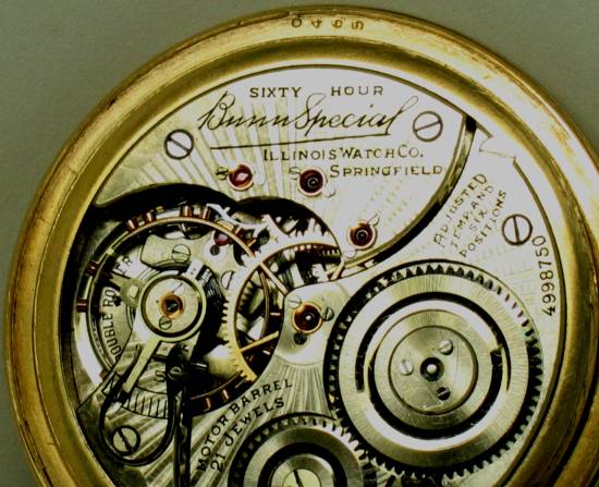

After seeing Lindell's clarification of Illinois 21J 60Hr Bunn Specials I decided to go look at the inside of one that I've got. Guess what, mine looks slightly differently again. So I'd like to solicit the RR experts opinions on what I have, and if it's the correct configuration for this particular model or not. By the way, the case is a 14K YGF, Bunn Special, Model 181 Fahys.

Dave, Your movement is a Type III 21 J 60 Hour Model 14 Bunn Special, over 86,000 made and yours dates to 1927/8 right at the Illinois buyout by Hamilton. All components of this movement look ok to me. Hope this helps and advise if there is something else about it or something specific you want to know? Happy Hunting!

thank you for your help, it's appreciated!! Smile
