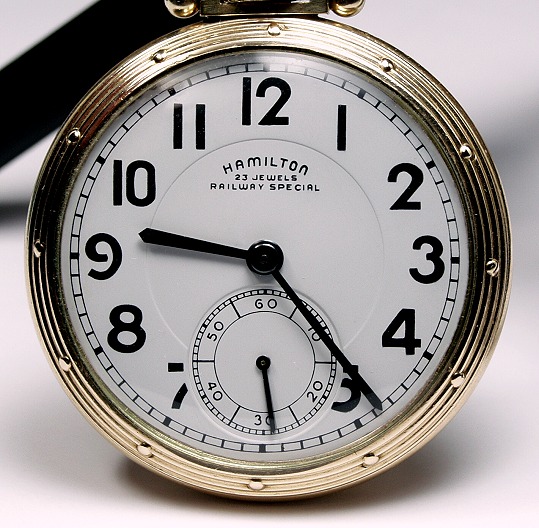

Melamine dials aren't as fragile as I thought..
This is a beautiful example of one of the later chalky melamine dials which had scuffs or stains under the 2:00 and 8:00. I had thought that these dials were nearly unfixable. Well, to my suprise, they're not. I didn't use polish, but I did fog the dial a little with my breath and wiped over and over in the affected areas. I repeated this method several times. To my pleasant suprise, the scuffs disappeared. I now know that these dials can be cleaned up, and are not as fragile as I thought. Thanks Lin for your advice and help. Smile
Believe me, this dial now looks great, and it's on a great watch.

Larry,
Is that an original melamine dial, or a later painted-metal reproduction? It's difficult to tell from just the image, but to me, it looks more like the latter than the former.
Original melamine dials are black on the back, while most painted-metal reproductions are bright brass. There are obviously other differences as well, but that's the most apparent one that readily comes to mind.

Larry Soucheck
Steve, it's 100% original. Black back and all. Smile
