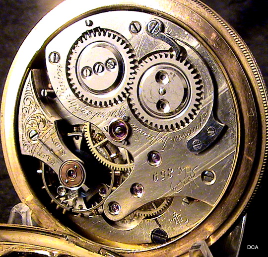

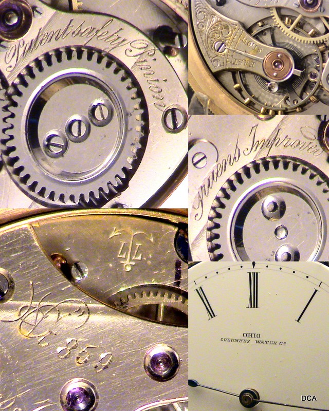

Deitrich Gruen started his first US Watch Company December 1874,in Columbus, Ohio. Naming it "Columbus", he imported Watches from a watchmaker in Madretsch, Switzerland marked with his name for his "new" patented safety pinion. Gruen adjusted and timed these movements which he sold for a few years until he decided(was persuaded by his stockholders) to make an all-American watch. It has been speculated that there were up to about 10,000 of the Swiss watches made with serial numbers reaching all the way to 70,000. Recently one of our members found an early example of one of these movement; Serial number 859, which was assuredly finished and timed by Mr. Gruen himself in the first year of business! The watch presents well . . .
February 05, 2013, 13:23
with a beautiful case marked "18" . . .
February 05, 2013, 13:29
a profoundly advanced 18s movement with 3/4 plate design, Breguet Hairspring, "Anchor" Escapement, well balanced wheel train and in-line escapement system. Such technically advanced features of an early 1870's design easily matched or surpassed the best of USA watchmakers in that time . . .
February 05, 2013, 13:40
But . . . this watch is 150 years old! In restoring it, I found 2 broken screws, bent 4th wheel seconds hand arbor, a replacement 4th wheel that is the correct tooth count but is 0.8 mm too large at the "points" of the wheel teeth causing stoppage at the escapement wheel pinion (until I carefully filed the teeth back and re-clearanced EACH ONE OF them!), a pallet stone which had been mis-adjusted and had to be re-sunk in, and the pallet lever bridge bent UP so that it had became a "stop" for the cycling balance wheel both ways as the cross arms "clanked" into the pallet bridge head.
EACH ONE OF THESE ISSUES were deceptively hard to sort out, and resulted in considerable time to correct.
I must advise ALL of our IHC185 members who are "DIY'ers" ("do it yourselfers")that you are working on an OLD WATCH which has suffered the ministrations of lord knows how many good and not so good watch repairers in the past.
WHEN YOU HIT A SNAG, ASK SOMEONE to look at the problem with you! These watches are becoming increasingly priceless artifacts of our creative history and deserve the best care to their restoration and maintenance. END OF RANT

The swiss movement; the Ohio Columbus Watch Co dial; Gruens Improved Patent safty Pinion on the plate brought back to life by you David.
Recognizing what it is and having the ABBEility and skills to fix it the right way could not be respected more.
