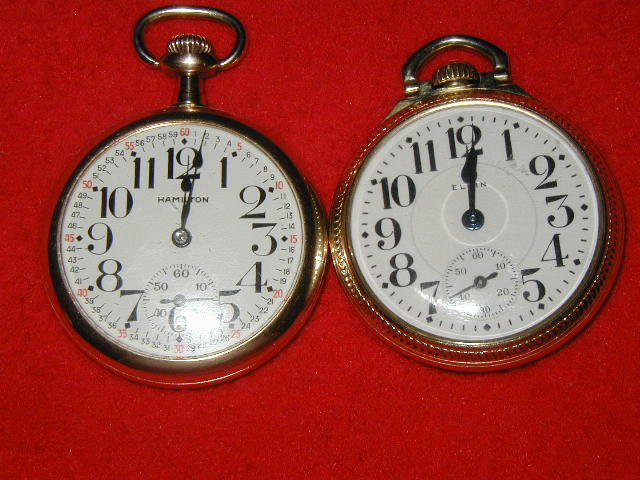

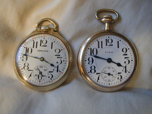

February 14, 2005 my 992B and Father Time watches arrived back from having their cases swapped. I could not be more pleased with them. Lindell Thanks for the Royal treatment. Thanks for the additional information about the crystal and dial on the Hamilton being incorrect for the piece. The cases are much smoother and brighter. Thanks for the attention there. Here they are for comparison to the way they were.

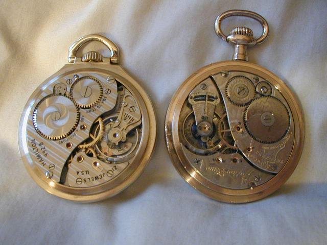

Richard J. Reidenbach
Here are their movements.

I forgot to mention the big screw in the center of your 992B crown wheel (smaller of the two winding wheels on your movement) was the wrong one. Since I was able to find one in my spares you now have the correct one.
