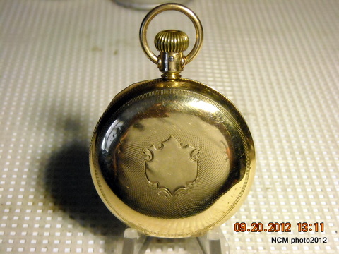

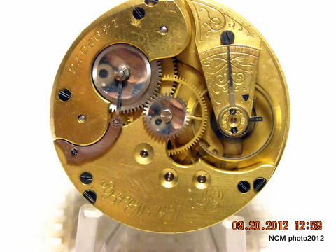

Good advice Jim.That's my next project.Here are a few pictures.It is in Jas.Boss dust proof,spring back case. I tried to get a shot of where it is signed.I've not ever seen one before.No other screw marks,looks original to case.Norm
