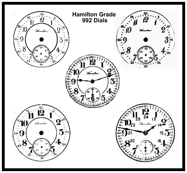

Hey all. I was wondering what case, dial, and hand combinations were available on the early Hamilton 992's. I believe that they were sold to jewelers uncased, but I could be wrong. But even if they were, I know they would have come with dials and hands. I know someone who is trying to restore a 1913 model. Any help would be appreciated. Thanks! Brad
September 25, 2011, 13:55

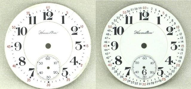

Richard RomeroAs to the dial and hands for a 1913 992 first it needs to be determined if the dial has three or four feet. The #436 and #581 signed Hamilton in script are correct. A proper set of hands would both be heavy spade. There's probably many more combinations but this would make a non-argumentative example.
RR
Heavy Arabic #436 on the left and Heavy Aribic Numerical #581 on the rightSeptember 25, 2011, 13:59
Richard RomeroHere's some other dials that were used on the 992. Around 1918 Hamilton started changing their signature to block letters. The Heavy Spade hands are shown on the center illustration of the #581 dial.
RR
Hamilton dials used on the 992 gradeSeptember 25, 2011, 14:03
Brad RichardsonThanks Richard. And since these were sold un cased, I would assume that just about anything from that time period would do? Regards, Brad
September 25, 2011, 14:34
Richard RomeroYou're welcome Brad,
It's always best to find a case where the movement case marks will match and yes a time period correct case would be nice. Pendants went from earlier being longer to shorter ones.
RR

Harry J. Hyaduck Sr.Hello,
I'm the member Brad is talking about. I have a 1913 992. It has the wrong type case and from what I understand it should have a long stem and not a short stem or basically no stem as it now has.
I also need to find new hands. There is a set on Ebay from a 992B. Do they use the same hands? The hands that are on it now I think are referred to as "New Moon" type hands.
And lastly the dial is correct a 436 according to the picture above however it is badly hairlined and a large chip at the two o'clock position. I will repair and clean it but I have found another dial similar to the ad above in the upper right hand corner. That dial appears to be single sunk where the rest seem to be double sunk. The dial I have found is double sunk but the rest of the dial looks identical to the upper right hand dial in the image. I know I could use it but would it be correct? My dial has 3 feet also.
Thank you for any input you wish to give me. Thank you,
Harry

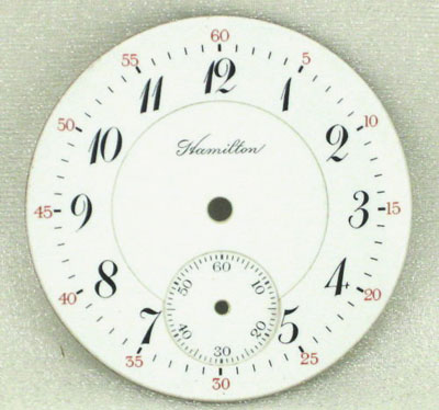

Harry J. Hyaduck Sr.Does anyone know if this dial would be correct on a 1913 992 movement?
Thank you,
Harry
September 27, 2011, 00:37
Absolutely!
In fact that is the Hamilton Script Signature phased-in by the 1905-06 period and then phased out, as Richard Romero explained above, in favor of a simple "Hamiltion" in block letters during the 1918-1920 timeframe.
That is one of several styles that would have been available in the 1913 period.
And to your other question, generally speaking, the hands that most of us tend to want for a 1913 era 992 are the style shown in the center of Richard's September 25th post above in this topic.

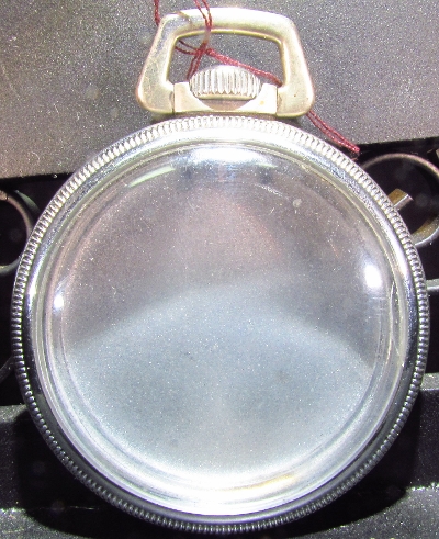

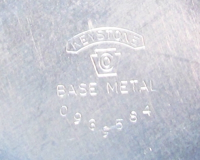

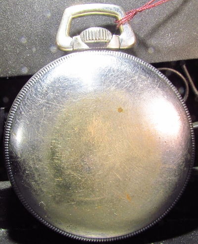

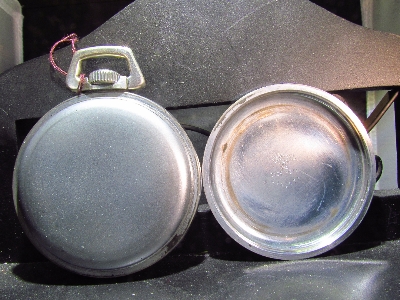

I have found some information the last couple of days that leads my to believe the case is an unmarked military case that my 1913 992 is in. It is a base metal Keystone case with a screw on front and rear cover. Inside the rear cover is a press on dust cover. I will try once more to download the photos. Do you think since the 992's were case at the jeweler that this was a way to hold down the cost back in 1913?
Harry
September 27, 2011, 13:39
Harry J. Hyaduck Sr.Could not get pictures to upload. I have re sized them and will try again.
September 27, 2011, 13:40
Harry J. Hyaduck Sr.This is the back.

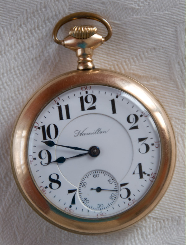

John A. CraftHarry,
this photo shows a 1912 940 in a Royal 20-year case that is (as far as I know) an original combination. It's not a perfect match to your situation - the 940 is an 18-size watch - but there are very similar 16-size cases listed on that rather well known auction site, in both gold filled and silverode.

Harry J. Hyaduck Sr.Back with dust cover attached.
September 27, 2011, 13:43
Harry J. Hyaduck Sr.And script inside rear cover.

I have both here that need cleaning up and new crystals. So do you think that the 1913 came in both silverloid and of course gold plated or filled? And can you confirm that this is a military case. I saw a military Hamilton on the Bay with the exact same case only it had inscription stamped or engraved on the back.
Harry
September 27, 2011, 13:57
John A. CraftThat does look like a case that was provided on some military contracts, but that doesn't mean this particular case was, as the same model might have been sold commercially.
