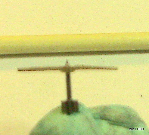

The Staking tools include Inverted cone, Flat and Ball end stakes which with the right stump can be used to safely reduce and re-size brass and nickel movement plate holes by 5-8% of the diameter. For example the dial plate side exit bearing diameter of a 16 size Elgin Center Wheel is about 0.35" (0.9 mm) diameter. By creating a little "continental drift" with the inverse cone stake, then compressing the hole with the flat end stake and recompressing with the ball end (about 250% the diameter of the hole) you can fairly easily re-size a 0.038" worn hole back to 0.35". Then I use centerless ground tapered swaging rods to polish the hole to an even better fit and finish.
If the hole is worn out too much more than that, it needs to be drilled out and re-bushed.

It is on its way back to you . . . running about 2-4 min a day fast. The third wheel was bent so much that it was hitting the motor barrel. I straightened it.
