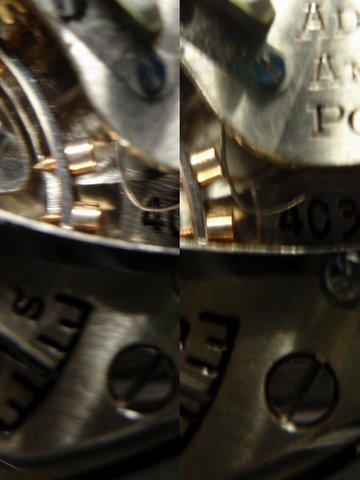

Here are two photos of the hacking mechanism on a 4992B, the left one is with the stem in the run position, the right one is with the stem out in the set position. The little wire hits the balance wheel & stops the movement.

Great pictures Tom,

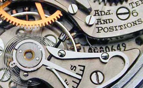

Yes, in the crown-out position that little stainless-steel wire functions as a brake that stops the balance wheel, thereby the entire train, but, and this is the important part, the watch remains under full power from the mainspring. For that reason it takes off immediately upon the crown being pushed in. The same principle came into play on most Railroad Approved mechanical wristwatches, it occurs electronically on Accutrons, as well as quartz watches and is used on many of the better automatic wristwatches even today.
Brake shown released during "crown-in" mode...
