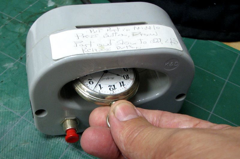

Robert, When you keep your watches near any electrically charged device, it will become magnetized. Such things as desk lamps with the straight Flourescent Light bars, Electric Fans, Small Power tools (Dremel, etc.), Jewelers lathe motors, COMPUTER TOWERS (MEGAZOOT Power supplies!).
If you wind about 1,000 turns of magnet wire around a 4-1/2 inch mandrel, squish it into an oval shape cast it with some epoxy or something, attach it to a switch, attach the coiled wire ends to each lead of an AC cord, you may be successful in either electrocuting yourself or making a demagnetizer that does a 60 Hz "Flux reversal" and thus cancels the magnetic charge in the watch.
OR Look on eBay or go to http://www.jewelerssupplies.com/product982.html and buy one . . .

My demagnatizer is something like David has but an older version with a button on the top and instructions on the bottom that I picked up off of ebay about 10-11 years ago. I have another that you sit the watch on and move it away that I need to rebuild but it appears to do the same process, form a magnetic flux field that counters the one effect in your watch.
