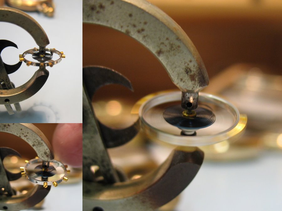

David AbbeMario, If it has a dirty balance spring it should be cleaned and then you can fix whatever anything wrong with the wheel too.
You had mentioned that there was a few thousandths of an inch (0.05 mm) "up-down" (we would refer to that as 'axial" runout) and did that show to be true when you looked at it with the loupe? We certainly agree about the quality of Veritas.
btw, you might note the wheel I pictured is an uncut invar "conversion" solid wheel for an Elgin. The Balance springs were dyed blue color because the Watchmakers did not think the white steel was any good.
