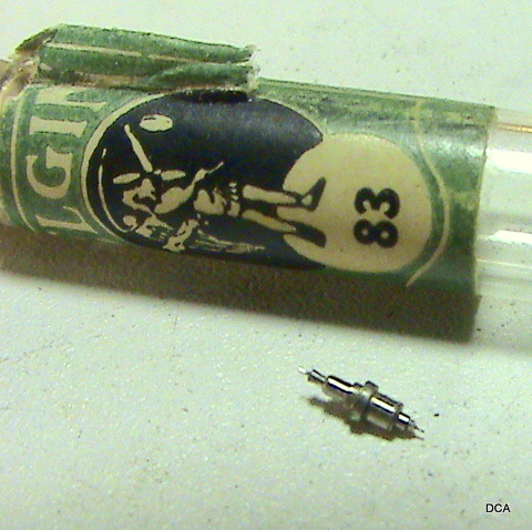

Claude The staff I pictured for you with oil stop pivots came from the Elgin Bottle in the background that came from one of two fully stocked 6 drawer Elgin Watch Parts Cabinets I bought as part of a couple watchmakers Estates.
A cheap reliable source I use for NEW staffs and certainly the one for you to buy one is:
http://www.jewelerssupplies.com/product9296.html
Often the factory movement finisher of these higher grade watches hand-fitted both pivots to the Jewels, meaning (I have found ) that the top and bottom pivots may not even be the same size. Also the End-Play is an issue when using a good new staff. Cas-Ker staffs work well for me and at their price you can get 2 "just in case">
