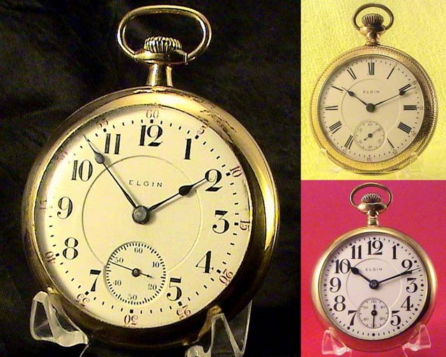

Some of my favorite Elgins have the Grade 240, 18 size, 19 jewel, 3/4 plate, damaskeened movement, made between 1899 and 1912.
I like them because they have a large diameter but a relatively thin profile. The 3/4 plate design lets you see down into the works and the elaborate damaskeening is just plain beautiful. Most of them are unstopable and keep good time.
I'm wondering if these were the last grade of 18 size watches Elgin made.
I'd also be interested in any anecdotes about these great old Grade 240 watches.
