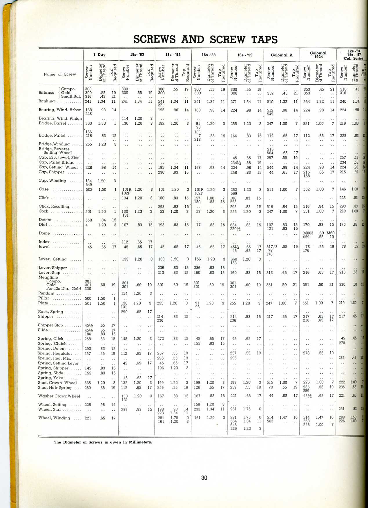

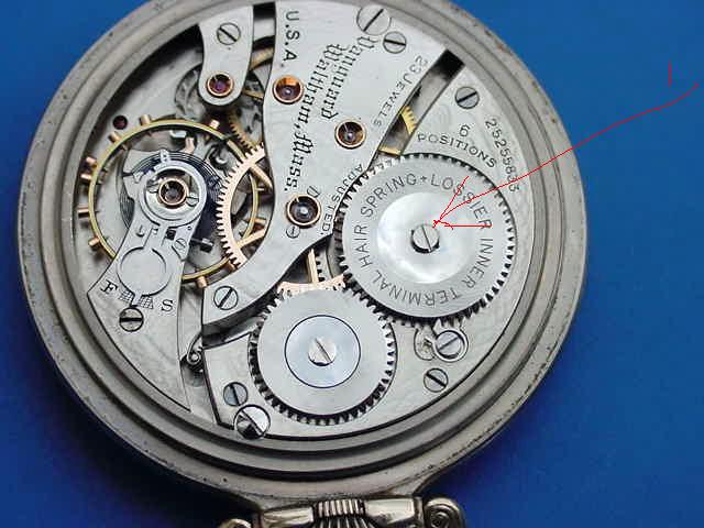

Can someone tell me the Waltham part number for the rachet wheel screw on the 23 jewel Vanguard indicator ,i can,t find the number in the books i have i do know that the screw from a 21 jewel crestent street parts watch i have won,t work, that tells me that the jeweled barrel must use a different screw.

Hey Samie, don't know if this will help, but it is the only info I have available....
September 27, 2010, 22:14
Samie L. Smith
Thanks Jerry yes that helps a lot ..
