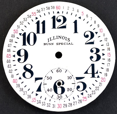

Gary OrrisI've been looking at the bay for Illinois Bunn Special dials & just found this one for sale.
It's a metal dial identical to the one fitted to my watch.
The numbers etc are all much clearer & better defined than my watch dial, but does this mean that my watch could originally have a metal Montgomery style dial ?
Regards ..... Gary
March 05, 2024, 06:10
Bila WirriganwaltersNo Gary, not a metal replacement of any type
March 05, 2024, 06:16
Gary OrrisThanks BW, Thought that was too good to be true.
Regards ..... Gary

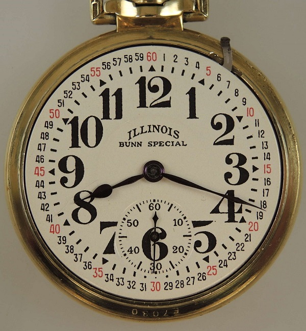

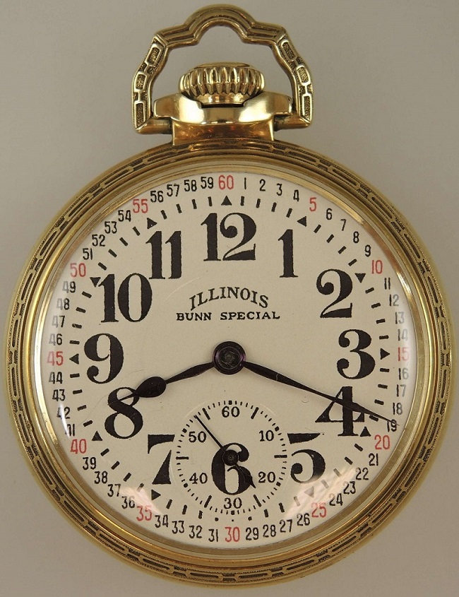

March 05, 2024, 11:00
Keith CambronGary,the correct dial for your movement is on ebay.it has 5 days left I think.fred Hansen has it for sale.
March 05, 2024, 18:12
Gary OrrisThanks Keith,
I think I'm watching that dial.

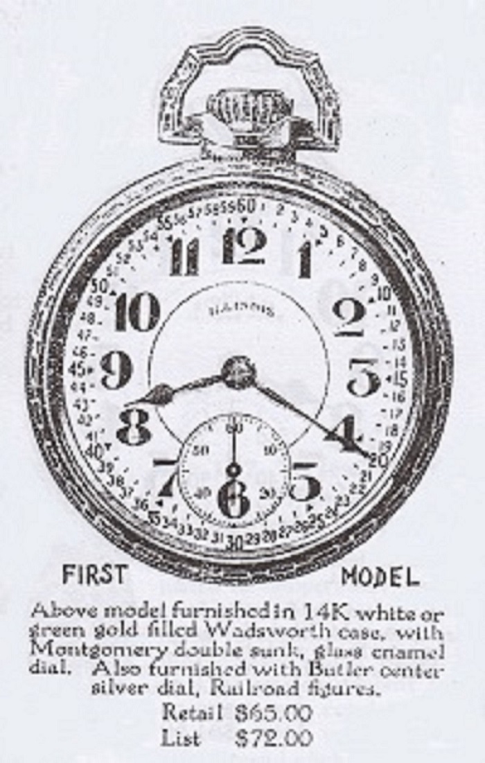

I feel a bit stupid really, because looking through my books I found a copy of Bill Meggers & Roy Ehrhardt's book American Pocket Watches volume 2 Illinois Watch Co. I can't believe I forgot I had that!
Here is a picture from the book showing a dial similar to mine but it's glass enamel.
Regards ..... Gary
March 05, 2024, 18:31
Gary OrrisJust to add: Everything else about that picture is correct.
My watch has the same Wadsorth 14k case with the same bow & hands. A Type 1
It keeps great time but I don't know when it was last serviced. I'll get it serviced when I get a correct dial for it to replace the metal "Fake".
Regards ..... Gary

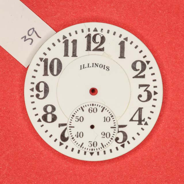

Mark PhelpsGary, I’ve got an original 16size Illinois double sunk watch dial. It’s not perfect, but let me know if you’re interested. I’ll try and figure out how to shrink the size of the photo I have. This won’t let me send it.
Mark
March 14, 2024, 15:16
Mark PhelpsI got it. It doesn’t say Bunn Special, but I have other Bunn Specials that don’t say it on the dial either. LMK.
March 15, 2024, 02:53
Bila WirriganwaltersMark, I wonder if you realise that the dial you have there has been over-soaked to clean it, hence the ink loss. Illinois dials are notorious for losing their Font and Numeral colour as it is not fired under the dial surface clear glass enamel, just stamped on top, seen plenty of them ruined.
March 15, 2024, 19:31
Gary OrrisThanks Mark, but I will be looking for the "Arrows In" variety.
Regards ..... Gary
March 15, 2024, 23:46
Mark PhelpsBila, no, that’s just the resampling to get the image small enough to post.
March 16, 2024, 21:24
Bila WirriganwaltersOk Mark, what program did you use for resizing as I have never seen them turn out like that before and I have resized plenty overthe years.
Still, it does not look right to me, still of the opinion that it has been heavily soaked to clean sometime in its life.
