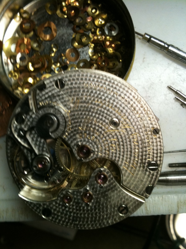

First off are these 3 dial foot Longines Swiss made or USA made. I was always under the assumption the where Canada Railroad grade watches.  Am I even close.
The movement is marked 21 jewel adjusted, Longines Express Monarch. Browns Hannibal Mo.

Eugene BuffardDeacon I Took the watch apart to give it a clean & oil and discovered a broken pivot on the Pallet fork pinion.
So I put it back together and save it for another day of repairing it.

Richard M. JonesEugene I really like those watches and actively look for them. Longines and Omega tried to play in the American Railroad watch market and the politics of the day and the American watch companies made that difficult. I have seen Longines that were accepted on at least some American railroads and I have an 18s Omega 21j hunter that was sold by a Tulsa railroad inspector. I got it from Dave Abbe. I have a 15j Longines like yours that has the pallet fork pinion you need (I believe). Let me know if that helps or if you want to sell yours!

Eugene BuffardRichard I would be interested in the pallet fork pinion.
If your watch is a complete watch I would rather make a pinion later for my watch than remove a part that would make your watch into a parts watch. If it is already a parts watch than I don't have a problem with the idea of using the pinion.
