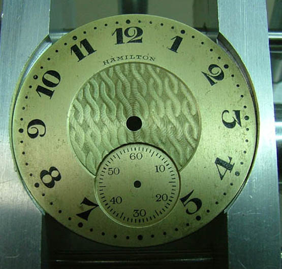

Before and after cleaning with soap. Not perfect but it did make a big difference. Thanks for all the answers. As always great information is available here. Paul

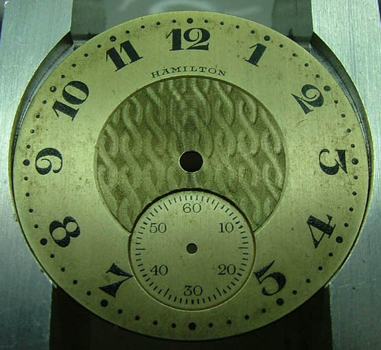

August 19, 2011, 08:37
Paul Arsenault
After

August 19, 2011, 10:21
Edward L. Parsons, Jr.
Nice cleaning job Paul, a slight bit of patina remaining, just as it should be. This is an old watch after all, and the rest of the watch is probably also showing signs of age too. You wouldn't want the dial to appear brand new.
August 19, 2011, 11:58
Phillip Sanchez
Ed's right Paul. Dial now looks just fine.
