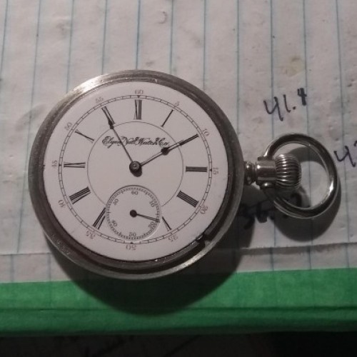

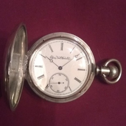

Rick HufnagelHere's some examples
Keystone coin silver hunter case, and then one I did just like you, nice movement I cleaned and oiled and unscrupulously recased it as a sidewinder in a Philadelphia nickel case.
February 14, 2020, 13:06
Rick HufnagelSidewinder, don't mind my dirty table please!! Haha

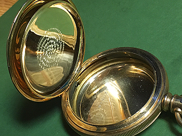

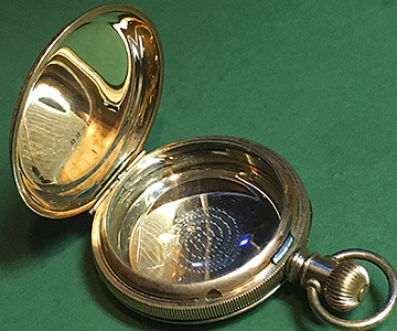

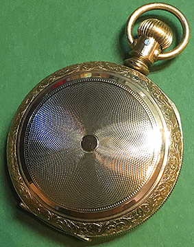

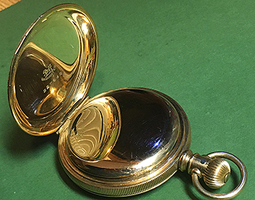

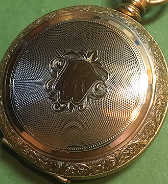

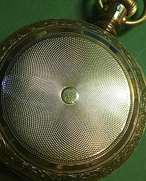

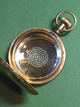

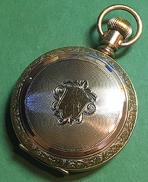

Harry J. Hyaduck Sr.Here are the pictures. Being extremely picky it is dirty. The screw on the pendant looks to be another screw and there are some scratches on front and rear cover in the center that should polish out easily and some scratches where you open the dust cover. All very not noticable and I am being very picky. The covers open to 90 degrees. I don't see any wear or dents. Should look fantastic polished and it has a female winding stem which you probably already know.
