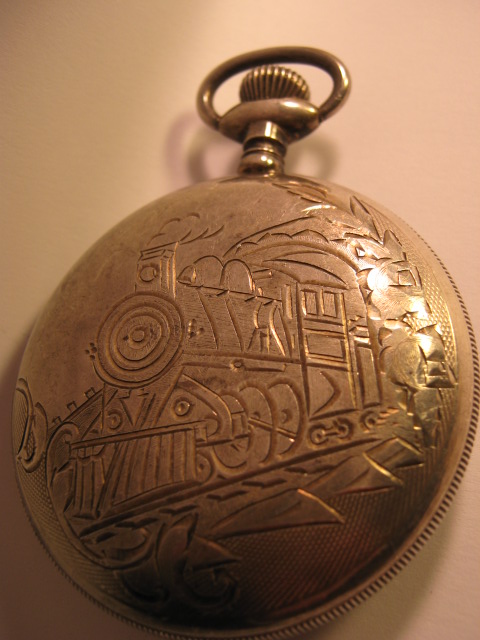

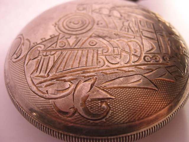

Thoughts on Shining or leaving Patina on Coin/sterling cases
I cannot get myself to polish this one...
The concept of undoing the years required to create this patina has me in a David Abbe frame of mind. Big Grin
Thoughts?

This is just my opinion..
If your going to resell it... Then leave the patina. You knw collectors are suckers for 100 or 200 years of smutz...
When I get a new watch, I take it apart and give it a good COA.. We clean the movements, why not clean the case too.. To me, there is nothing better than a clean, shinny, movement housed in a nice shinny case (coin silver is gorgeous when cleaned)
Just my cent worth. ( I would clean the case Big Grin

I am in the clean the case and get rid of the grime and oxidation. I have picked up a few nice coin/sterling case because they had a boat load of patina on them, cleaned up they look great.

Two for cleaning, and still on the fence

The contrast of dull patina on low spots and bright on the high from daily or occasional carrying is the best of both worlds IMHO. Giving the watch a look of having a "real life" and functional day to day appearance.

The patina allows the detail of the train and other engraving to show through much better than a polished watch would allow. Polishing the watch will also degrade the crispness of the detail. I'd leave it alone and enjoy it.
If the watch were a plain silver case, I'd polish it. The patina will come back soon enough.

If you take boiling hot water, add a strip of aluminum foil, set a heavily tarnished silver object in, and add a half a cup or so of baking soda a little at a time and let set a few minutes all the tarnish comes right off without any loss of detail or pitting. What residue is left wipes right off with a dry cloth. You must do this in a sink as a bubbling action will occur that may over run your pan. We remove the crystal bezel if the crystal is intact and the movement of course first. This process does a fantastic job in about 5 to 10 min and a follow up with a very light minimal buffing to take care of the surface scratches and you would be amazed. It also gets all the grime out of the hinges and case springs exceedingly well. There is no loss of detail with this tarnish removal method but it is only to be used on silver and not silver plate.
On one hand I like the look of a tarnished silver watch but on the other hand I know that the tarnish is doing damage to the silver.

Patina = A surface appearance of something grown beautiful especially with age or use.
I’m usually in favor of polishing but not in this case. It looks great the way it is.
