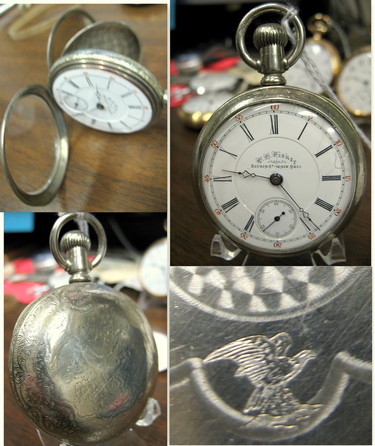

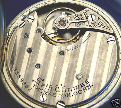

Mario PaganiHelp on a Seth Thomas please
I do like Seth Thomas, both clocks and PWs, but I don't know much about Seth PWs. Can you kindly give me some info about this ? It should be a model 6, 18s, but that's all I know
Thanks a lot

Cecil McGeeHey Mario,
You are right,it is a model 6,18 size,looks to be 7 jewels,and made in 1909.

David AbbeMario, This looks like a nice example of a well-trained" (pun intended
) movement design that migrated all through the "low-end" watches. You will see the same idea on Seth 16s and 18s, and also Trenton, New York Standard, and their sub-names. They are all "flashbacks" to some early ideas that were done by Waltham, etc.
The Balance Jewels are press fit, no jewel screws so the "end-shake" can be adjusted right at assembly by the "swiss" method. That makes these easy to get going, but they are only a 1/2-step above "Dollar" watches, for quality of time.
I see this design as made by Seth Thomas as the most "respectable" one because it IS a Seth Thomas and they clean up nicely.
