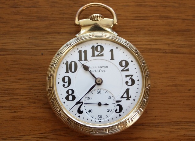

Here's the Illinois Burltington Bull Dog illustrating the Heavy Crystal. The Bull Dog cases are marked "Bull Dog" meaning only an Illinois Burlington movement is correct.
RR

Richard - thanks for the photo. I bet the green 14k GF case was a looker

Here's my Green 14k GF Bull Dog. Complete with HEAVY DUTY CHRYSTAL by William White. The case is the optional 185 shown above.
RR

That is awesome! The dial and the case go hand-in-hand
